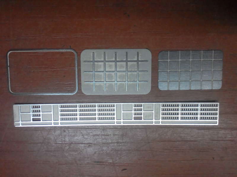

Today I wanted to arrange some of the resin castings
to check whether the gear wheels would finally fit together properly.
But what's that? The styrene sheet had been softened by the resin parts!
I never had problems with resin parts like this. What went wrong?
Regards, Peter
