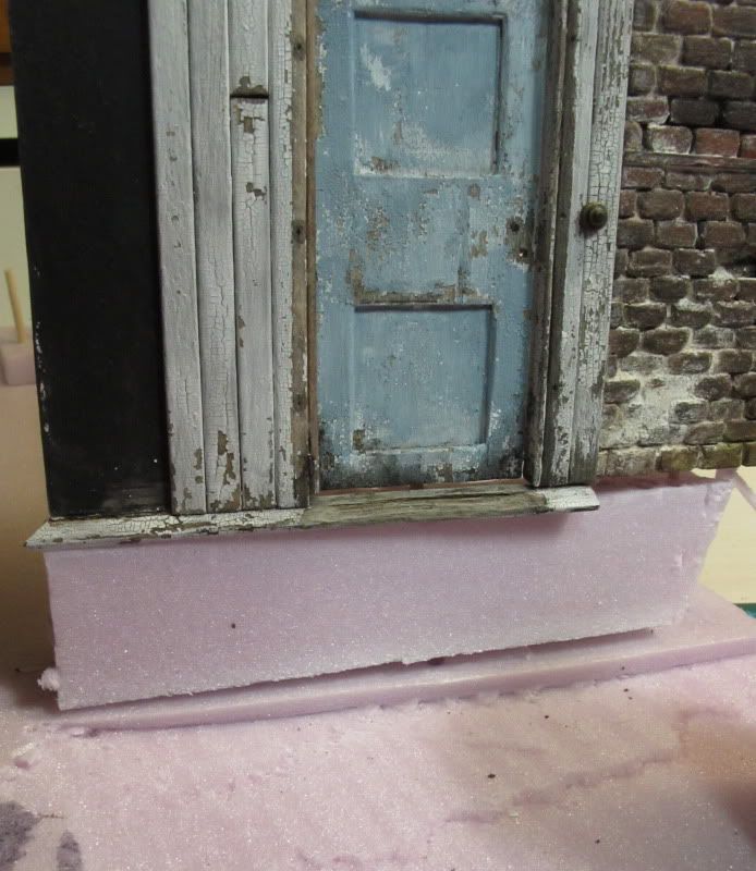

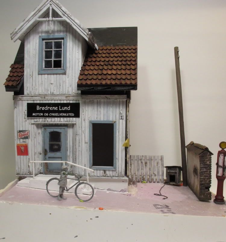

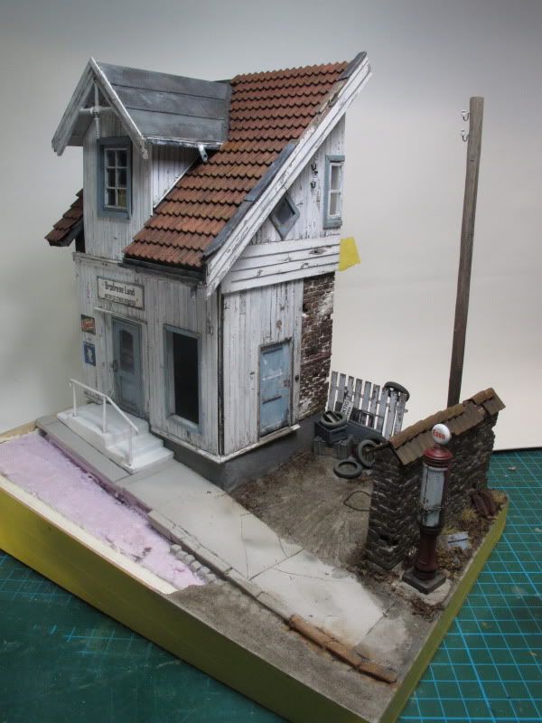

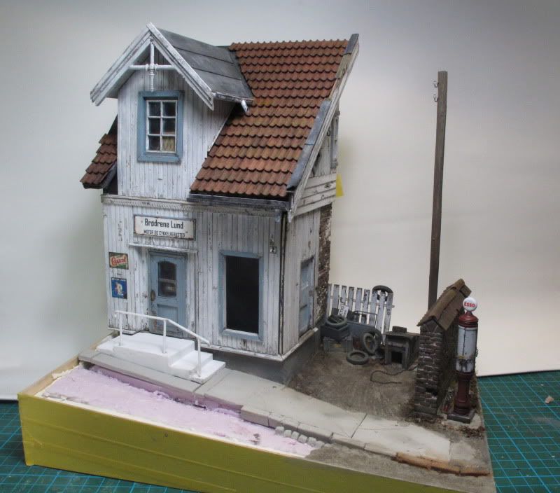

Hi Philip --
I'm sure my brickwork will give Nick terrible nightmares, but I'll post a photo anyway!  ;D
Found Liquitex "Ceramic Stucco" (medium) to be a very easy item to use for mortar.  I put a scoop of that into a little 1 oz. medicine cup and add a TINY dab of color.  If you take say 1/2 oz. of the stucco medium and add a drop of Vallejo black, you'd think it would turn a nice gray, but it quickly turns black.  So, either use a nice light/medium gray paint to color the stuff or a tiny dab of black or dark gray.
Stir that up, then put it into a blunt syringe -- type used for refilling ink cartridges, etc.  If you try using one with a long metal tip, you'll find that it takes a ridiculous amount of pressure to move the stucco thru the needle -- the kind of pressure that makes tendons pop out (or at least get inflamed) so either cut the needle short or use one of those extruded glue-tip extenders over the tip.
You can work the stuff into the grooves with a finger tip and wipe of the excess the same way.  If you SLIGHTLY dampen your fingertip with water, that can help ... but you don't want to flood with water, cuz the stuff will get runny, etc. and make a mess.   You can clean up the syringe with water.  I fill it multiple times and then squirt it out into a BOTTLE for disposal -- figure you don't want the stucco stuff hardening in the pipes.
Liquitex Ceramic Stucco is available at Michaels, art shops, etc.
Yes, I know the needle tip in the first photo "looks funny" -- that's why I posted it!  ;D

What scale is that brick wall?
my brownstone blocks are about 1/2" long 1/4"tall and 19/64" depth. LG for o-scale.. looks pretty close to brownstone I suppose..

My wall is 1/35 scale -- bricks are a bit under 1/8 x 1/4" on the exposed side.  I'll think about the molds ... Dallas
