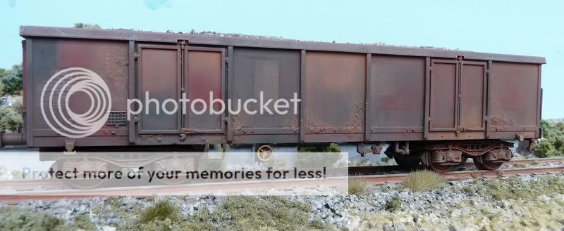

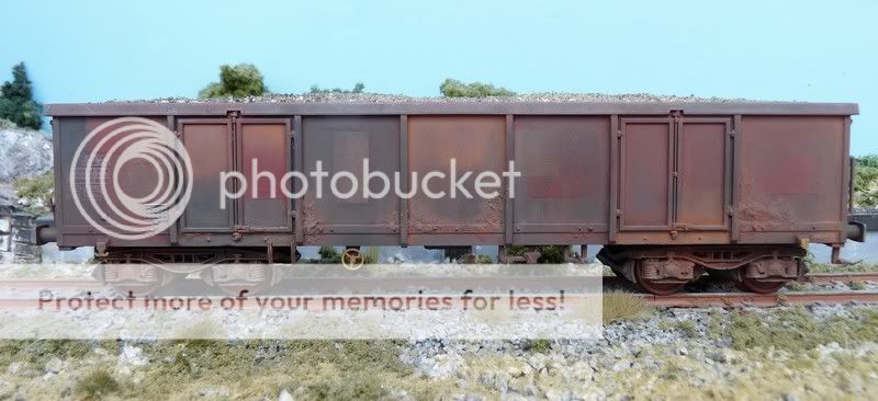

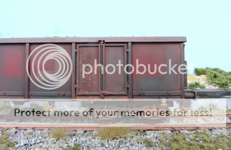

I've been doing some weathering on some of the spoils of Dortmund; boxcars, loco's etc in my spare time.
There was this one incident that I captured photo's of a rake of gondols from the train while travelling  from Dortmund. They were perfect examples of how an aged gondol would look like. The photos were taken while the train was in motion so excuse the blurriness.
...and my version on a 1:87 Roco Gondol;
Erkut

Erkut, wonderful weathering but I can't help but notice the lack of bulges and denting as are seen in the prototype. Is anyone out there proficient in creating dents in plastic. I have tried with the soldering iron and a piece of brass shim but my efforts aren't completely satisfactory. I suppose I should ask the question in "tips and techniques" so I don't hijack this thread. Otherwise a great job Erkut.

Another thing that comes to my mind is the same method I used in making the flaking rust but on a much more larger scale.The flakes were done by mixing the appropriate powders with PVA glue with a touch of water.You have a muddy mixture. Then applied to the body with a bristle brush.
