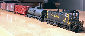

Okay, so here I am in the corner. I was bored to death so I grabbed my iPhone to test its depth of field. I set up a bright light (to make the f/stop automatically shrink as much as possible), plunked some HO freight cars and an NW2 on the kitchen table, and took photos. I doubt the forum's file size limitation will resolve enough detail but first I shot this photo with my iPhone 7 Plus "telephoto" or "portrait" lens. Regular iPhones (like iPhone 6 or 7, not Plus) don't have that extra lens. Just as well because it probably would require too many image layers to produce much depth of field. This (single exposure) is what the camera saw though that lens.
Just as I feared: I focused on the tank car and it's sharp. You can't see how fuzzy the two ends of the train are. Useless image.

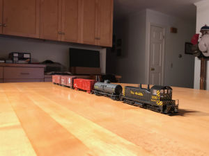

Then I shot a couple of images through the regular lens. It's the same lens as every iPhone has and most other smartphone lenses are nearly the same. Better, but the end of the train is soft. I doubt it will be evident in the attachment. Here it is anyway.
#18
I shot a second image through the "regular" lens and focused on the end of the train. That gave me two essentially identical photos, one with the front in focus, the other with the rear in focus.
I opened both images in Photoshop, layered the one with the loco in focus over the one with the end of train in focus, and erased everything that looked fuzzy. The result is pretty good, comparable to images I took through my 3 and 5 megapixel digicams years ago and maybe better. Certainly with much higher resolution.
As you may recall, the point of the experiment was to see whether Havard and the rest of us can achieve model shots with satisfactory depth of field using a smartphone and, at the same time, get the "scale man" perspective the old digicams gave. I think the answer is yes, and you probably don't have to stack images to get decent depth of field. I think the single exposure depth of field is close to the best I could get with my early digicams. If you want more, stack two or three images with different points of focus (without changing the camera's position!), and it may be possible to produce the look you want with the 12 megapixel resolution of today's smartphones.
