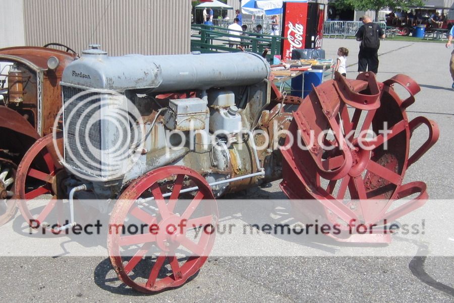

Saw this at a truck show. Like the soft ground/mud wheels.
Those wheels look like something I'd make when "measure twice, cut once" slips my mind!  Of course, they've still got room to cut those pieces down a bit.  ;D  -- Dallas
There seems no end to the variety of attachments applied to the Fordson. Thanks Chester!
