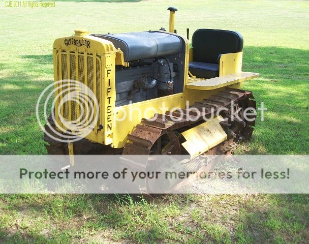

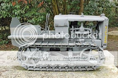

Eventually will start a new thread for this but just to add to the variations for this kit this is what I am doing with it
1/24 Caterpillar Fifteen ( it might end up as a 7C Fifteen?)
Cat Fifteen
Cat Fifteen 7c
The basic running gear of the S65 is almost spot on for a 1/24 Cat 15, most the running gear is shared across the Cat 5, 10 and Twenty  so there are other options  ;) although layout does differ from model to model.
Obviously the body work will have to be scratched, and I am playing around modifying bits of the kit to see what would work and what will not .
Here is the kit radiator, Russian markings removed and narrowed by about 4 mm to get it closer to the body width of the "15"  ........... which meant that I then had to scratch a new fan shroud( an interesting little build  :))
Still need to sort out new starting handle access and the radiator filler , as well as Cat name and cast lettering, etc.
