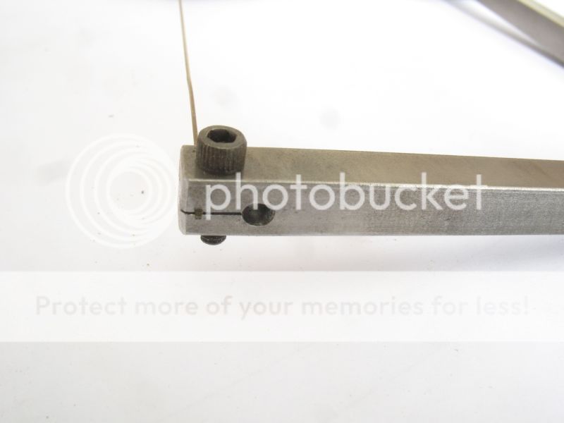

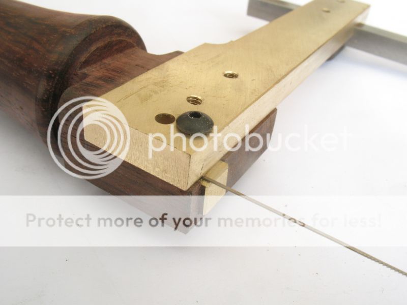

The saw that I made was done with a scrap of rosewood for the handle it was turned on the lathe and then a flat milled across the work end to accept a piece of 1/4 inch thick brass.
A small 1/4 inch by 1/4 inch channel was milled parallel to the axis of the handle to accept the brass locking bar. A 4x40 thread was cut into the bar and a clearance through the horizontal frame bar. The domed allen head screw is used to clamp the 2 pieces of brass together thereby clamping the blade between

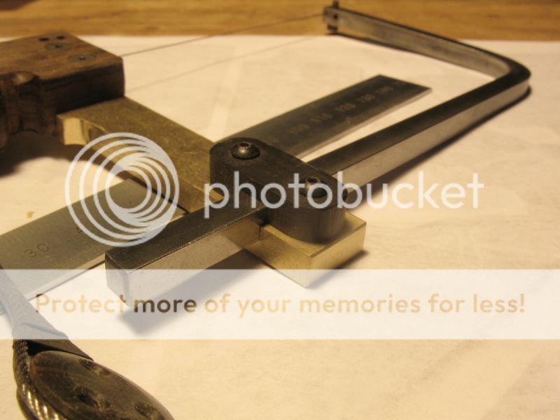

the frame member of steel is 1/4 x 1/4 inch heated and bent to create the open area of the frame it is clamped to the brass bar with a bridge of ebony and 2 4x40 allen head machine screws.
The top locking screw is a 4x40 allen head cap screw that squeezes the thinner section of the slotted end to the thicker part the slott is caut with a .010" slotting saw in the mill. The overall proportions were based on the regular jewelers saw.
As was pointed out in the earlier thread I could have replaced the thumb screws with some allen headed screws and it would have achieved the same results. I now have two saws so can have a coarse and a fine blade set without having to change blades.

I hope that all that weight of the brass, doesn't make you get a sore wrist when your using it.

Greenie it is a good question. Sometimes the destination is not so critical for me as the journey. I actually already happen to have the saw you linked to along with several others. My saw feels good to me in my hands. one day when I am pushing up daisies my grandchildren will have a few unique items that you just cannot get on Ebay they are passed down.

I did not do any drawings but just used the materials I had to hand, Ill do up a quick sketch and post it.

Lovely saw. I love when tools themselves are a worl of art. I have a question of curiosity though....why use Ebony for the samll bridge piece instead of brass, or some other metal?...purely aesthetic?...will it hold up as well over time/use/adjustments?

Marc - As for the ebony retainer, it probably was the right size to start with and it looks good there.  And if he'd used a brass part, the retaining screws would also have to be brass which might have meant a trip to the hardware store for a part not in the closet.
