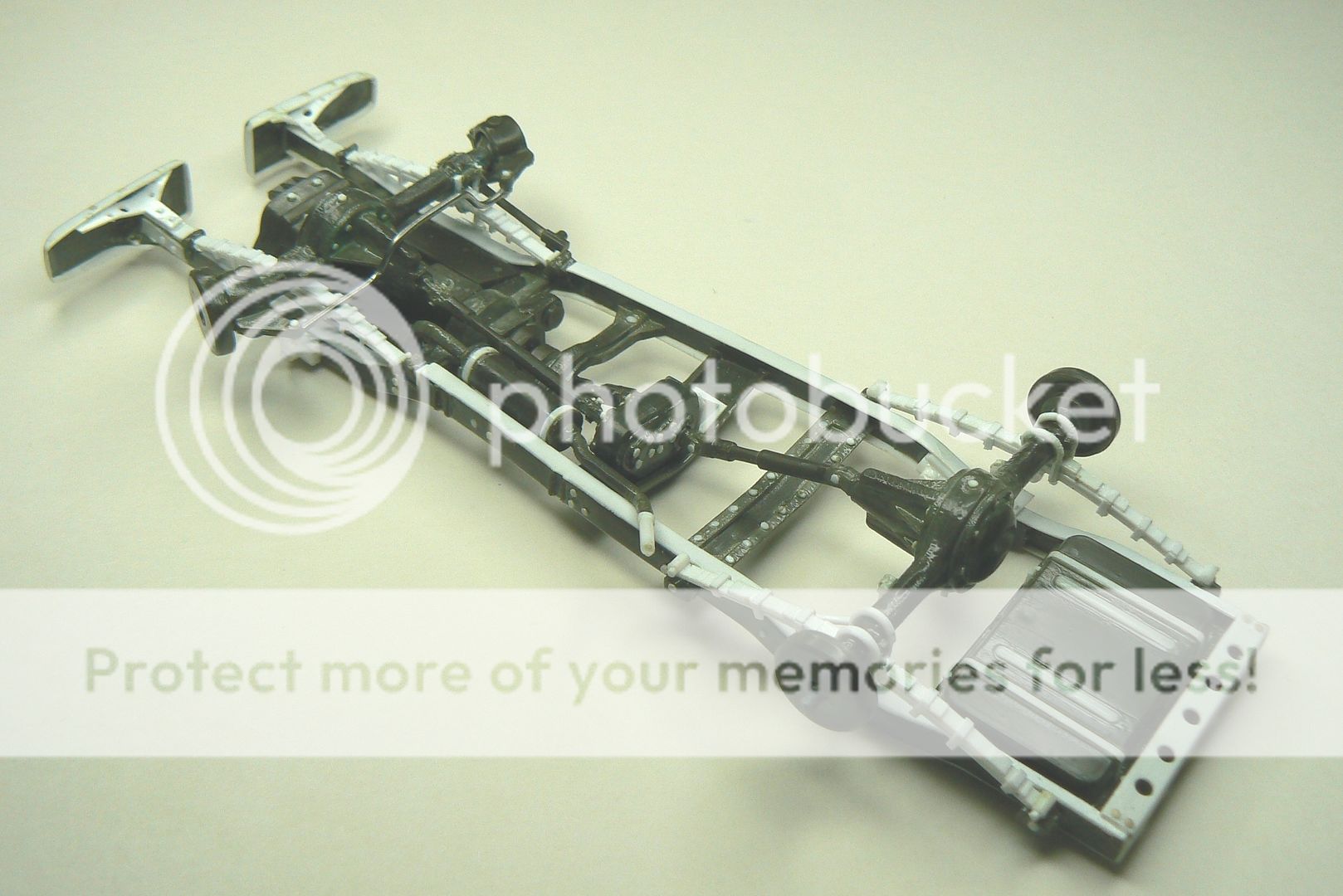

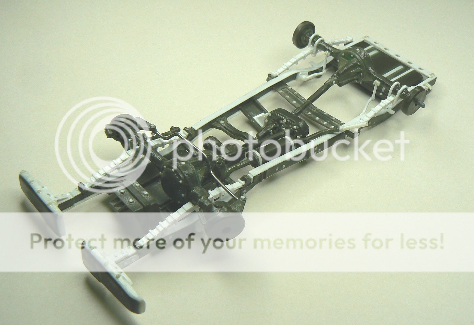

Now, despite repeated attempts by friends to tell me different the Airfix kit is basically OK, reasonably accurate if a bit coarse in places  however my mistake was to find on-line a Dodge workshop manual with lots of lovely drawings, etc ........... so what do I do, I start tinkering and trying to improve the basic chassis ......... bit of thinning, few additions and after a couple of weeks got to this stage
Now bare in mind I am modelling this thing the right way up, so very little of this will ever be seen again .......... that nice canvas jacket with buckles up the back is coming over the horizon again.

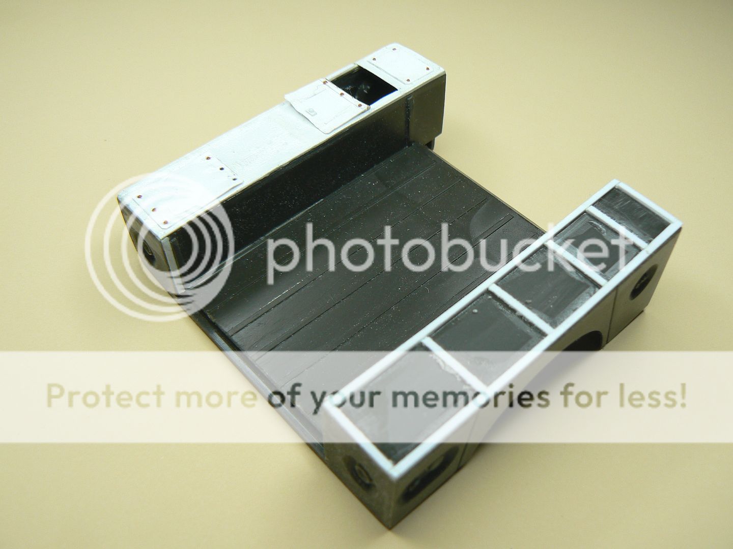

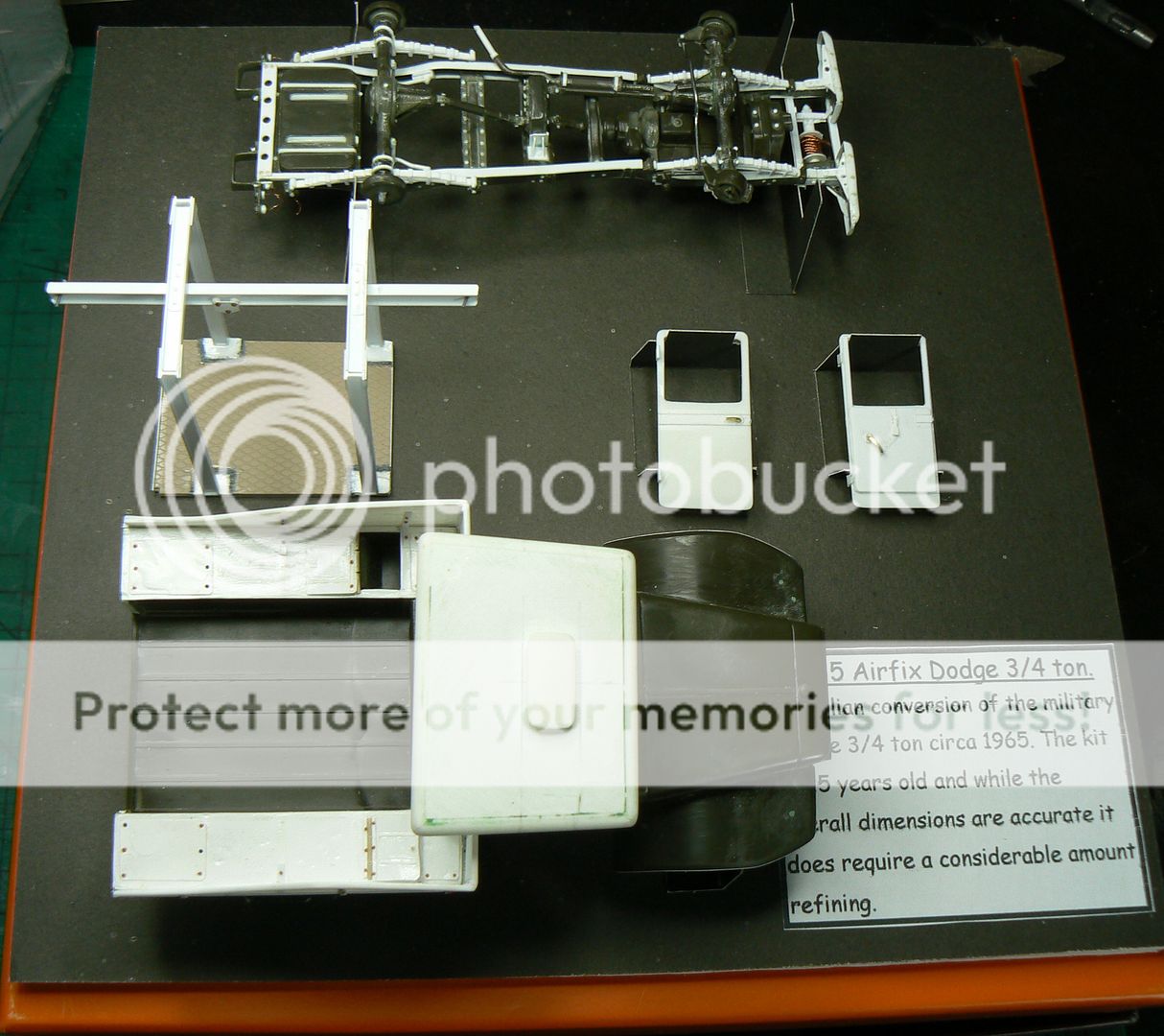

Anyway continued on with the body, in the cargo compartment everything seemed very square and new , this model is meant to represent something that is at least 20 years old. So I used a technique I have done before on modern warships and sanded of the the top detail on the storage compartment , built a frame work out of 10 thou card and then covered that with 5 thou card ...... gives you that sort of rippled effect you get with thin metal over an internal  frame work. Hopefully will show a little better when some paint is applied.

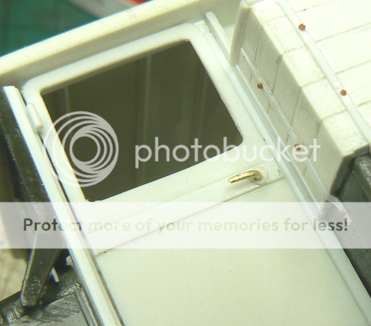

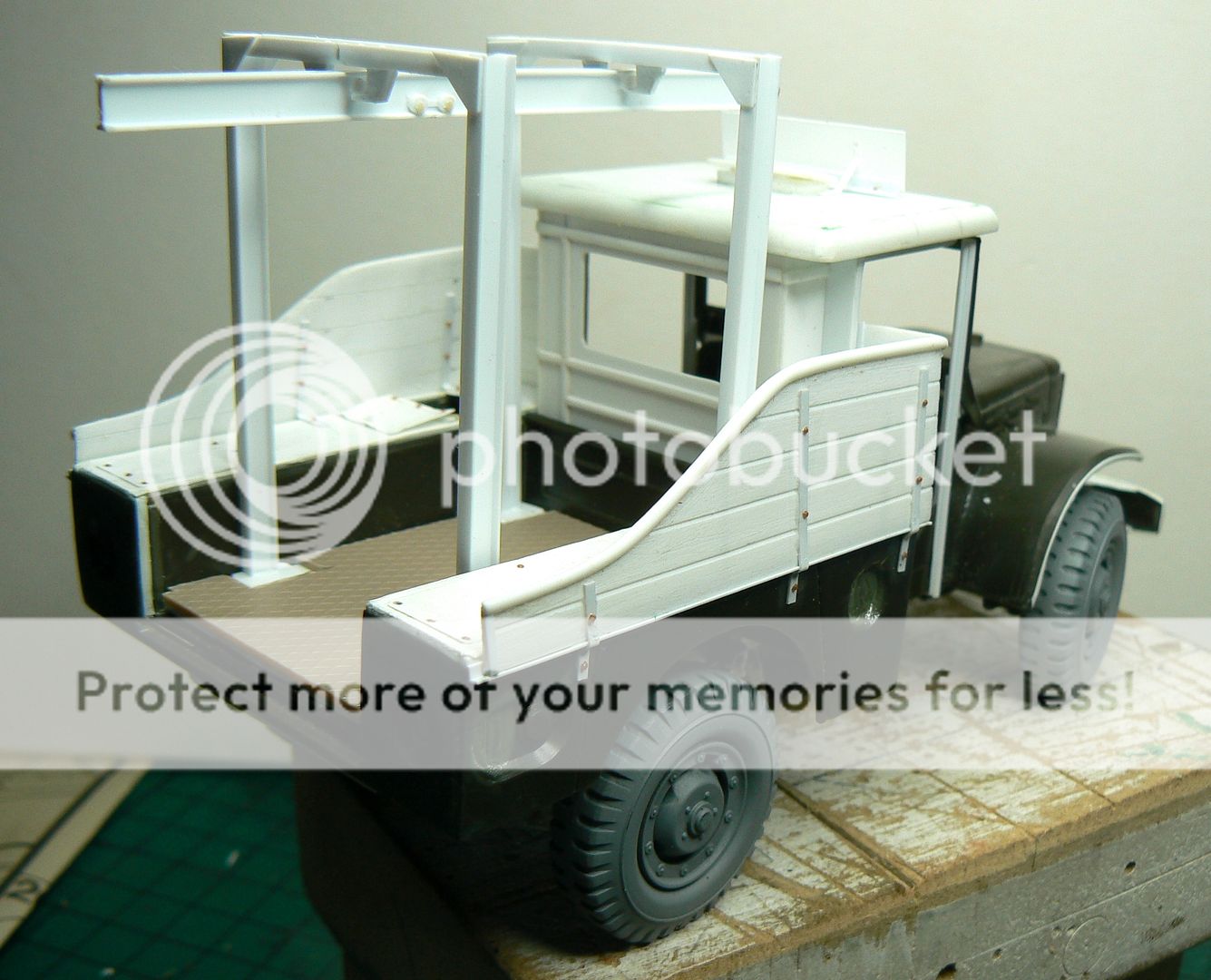

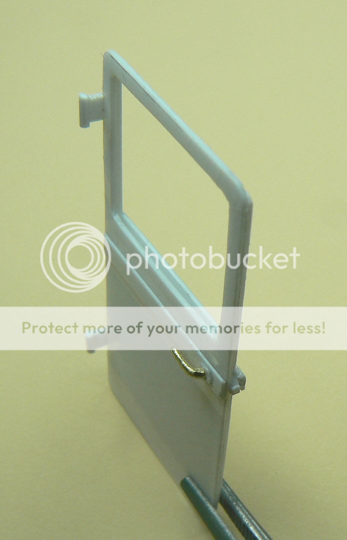

Work continued on this quick build, a new cab being built , roof and side boards for the rear compartment, etc. The doors were  fun, I basically just copied puckhogs work http://www.finescalerr.com/smf/index.php?topic=1451.msg26349#msg26349  including leaving a channel for adding the window glass later but all in plastic rather than metal

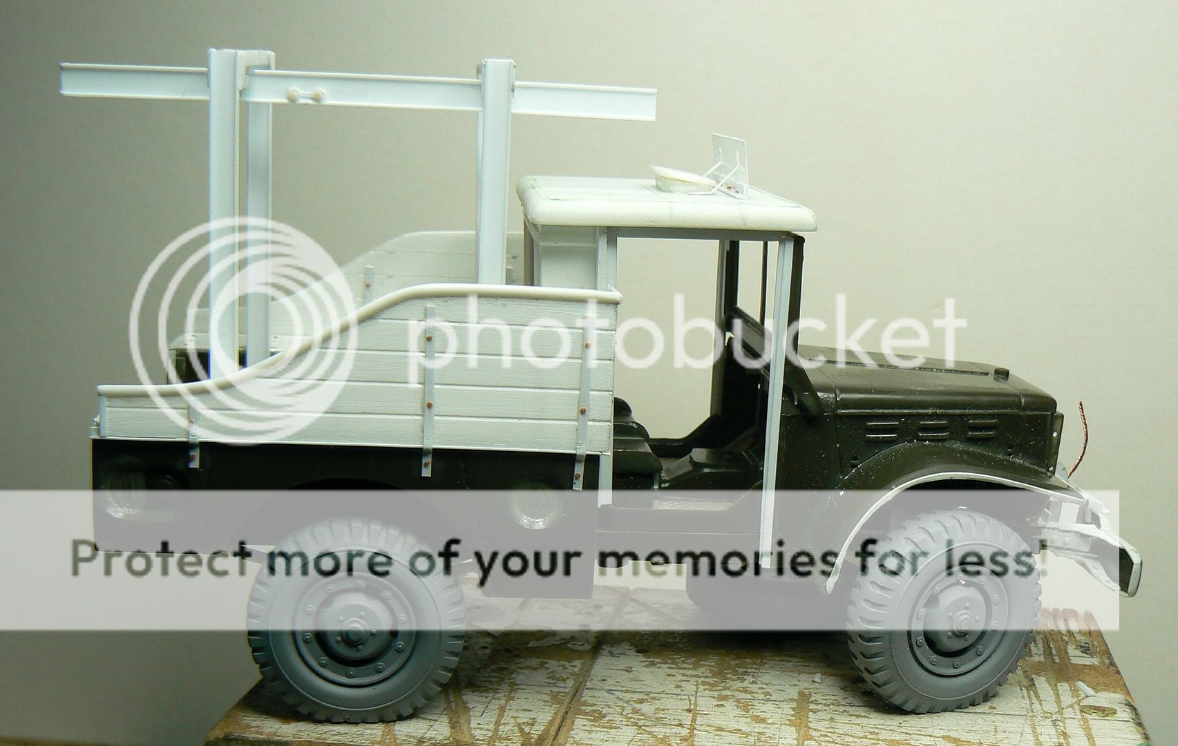

So here is where we are now , most of the bits are just placed in position both to ease painting and as you can see to allow me to set up and display  the model showing some of the construction for a small show in a few weeks time
Two "Wows" and another "Satisfactory" plus an AIRFIX award for the year -nice work
Beautiful! Really a wonderfal bit of scratch work and detailing to bring this kit up to snuff. Good luck at the show (neat little base as well, like the frame stands/braces). Look forward to your painting on this!

The show is the Slim Gauge Circle do at at Bilton, Barney asked if I could provide a couple of models for the Phoenix Group display/workshop they are puting on there .................. I can't attend so have been trying to mount/display the models  and provide a brief explanation of what i am trying to achieve so that they don't have to remember or waste time puting the models together.
