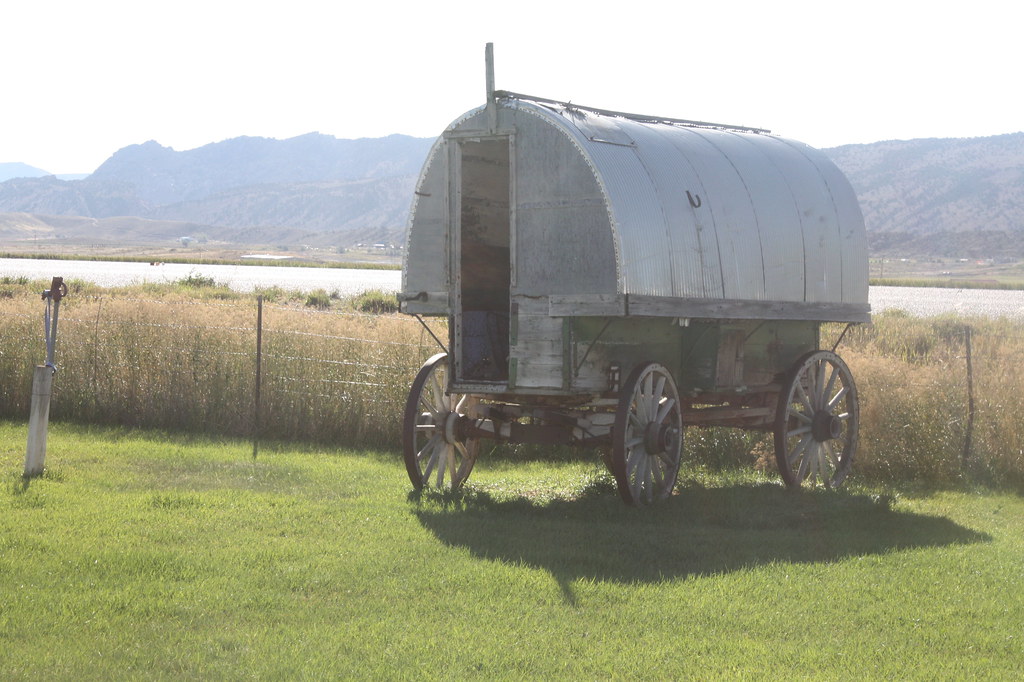

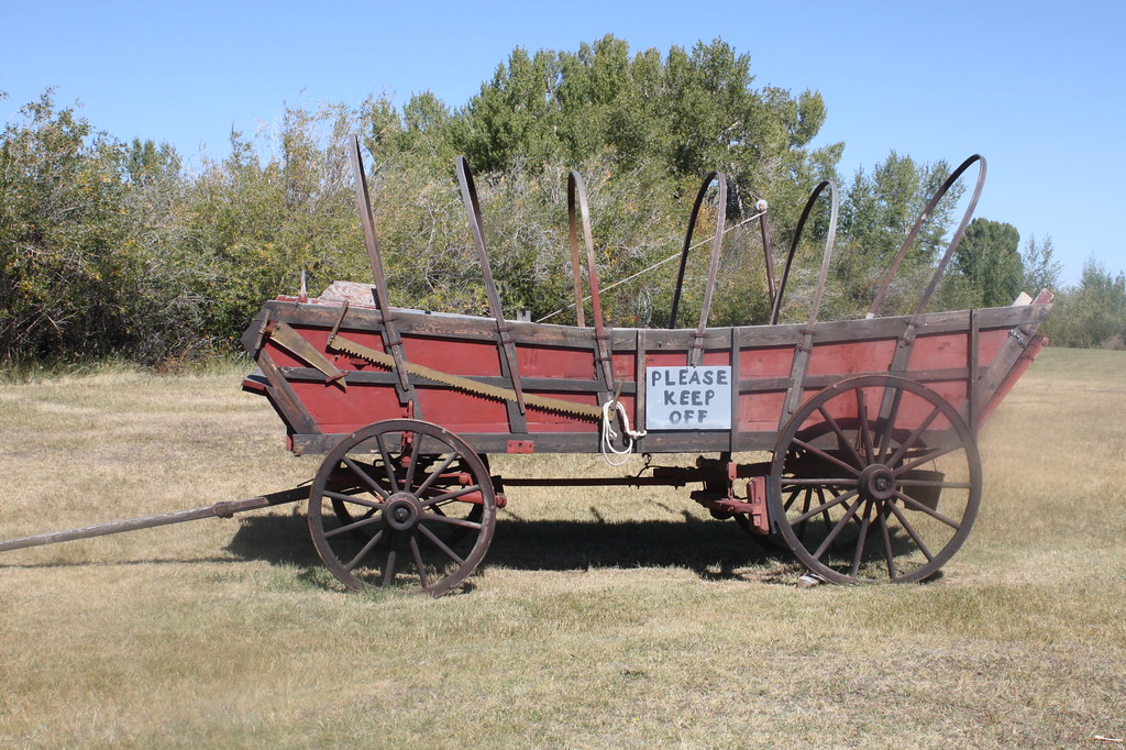

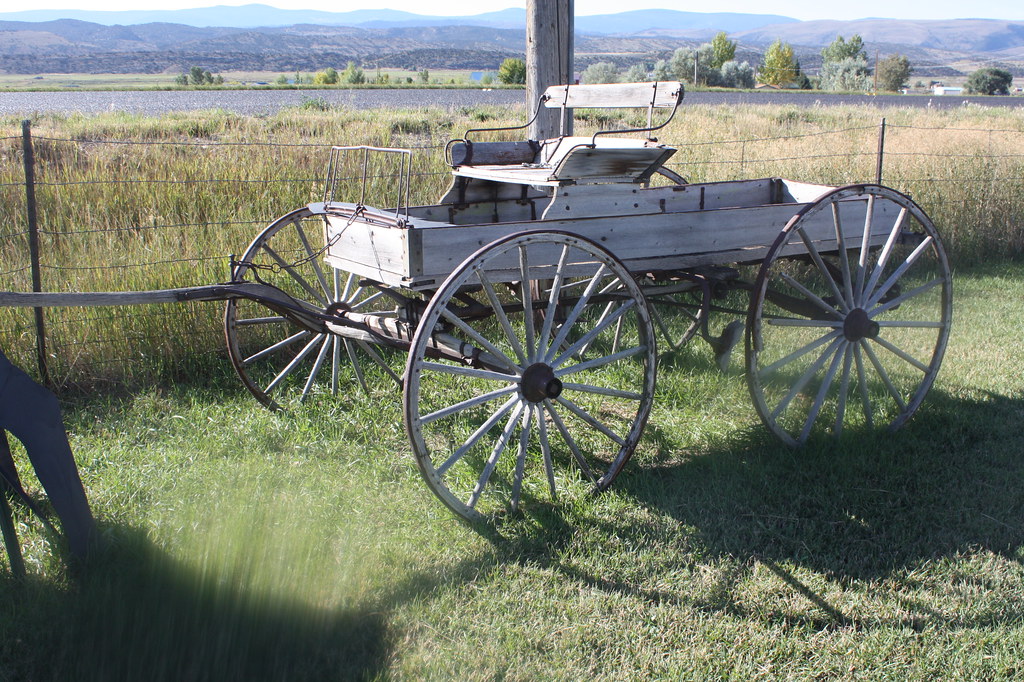

Here's photos of three wagons I found on my two day road trip I took last week. The sheep-header wagon and the small wagon I found in Manila, Utah. The other wagon was at the Fort Bridger museum in Fort Bridger, Wyoming.
I have 36 other photos from this trip over on my Flickr page.
