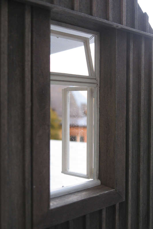

For the putty problem, would it possible to first apply some kind of mask on the window glass that covers all but the narrow edges where the putty will be applied? Maybe a thin removable tape like Scotch removable tape. There are also very thin frisket/masking films that can be cut to size. And there are water soluble masking fluids that could be applied and washed off after the putty sets

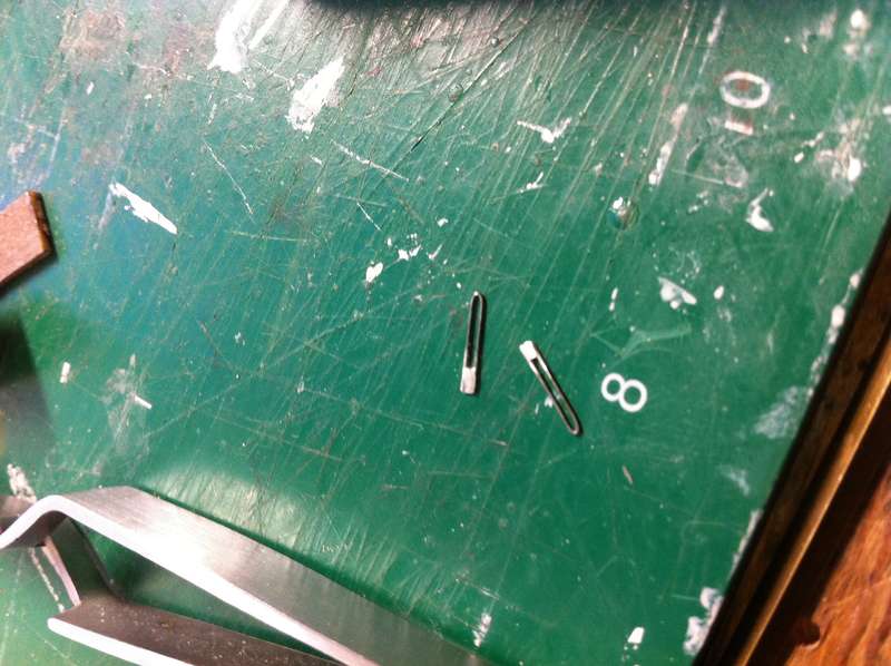

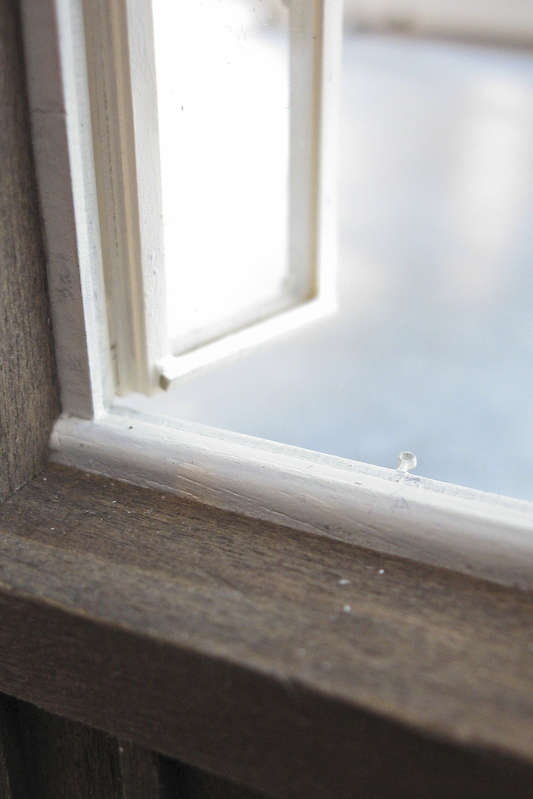

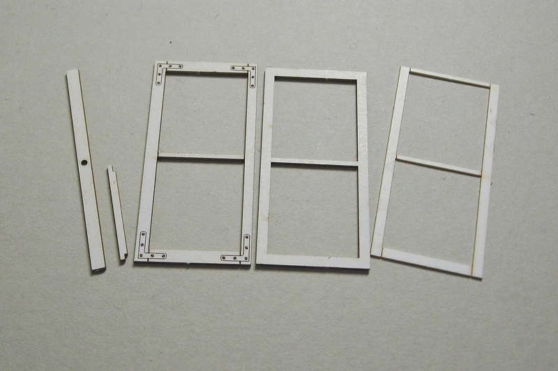

The barely visible upper window runners are bent from some 0.3 mm steel wire and soldered to a tiny brass piece to be drilled afterwards for having a functional window. The frame's hinge is a angled 0.4 mm brass rivet as the window's guide pin is (this one not angled).

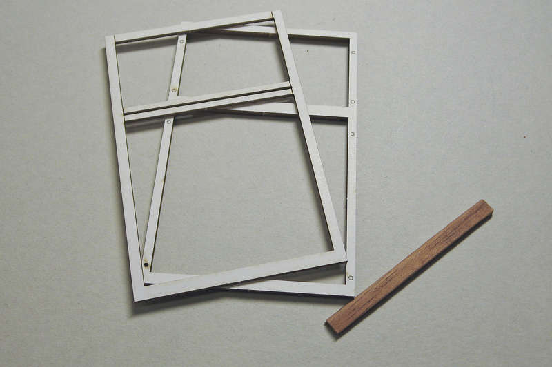

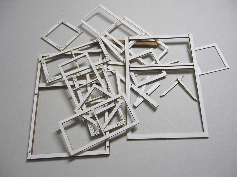

A set of frames for one window consists of those lasered parts:
Outer frame from two layers, 2 and 1 mm diameter. And there's piece of sanded wood for the lowest frame bar:
The house has some 20 windows.

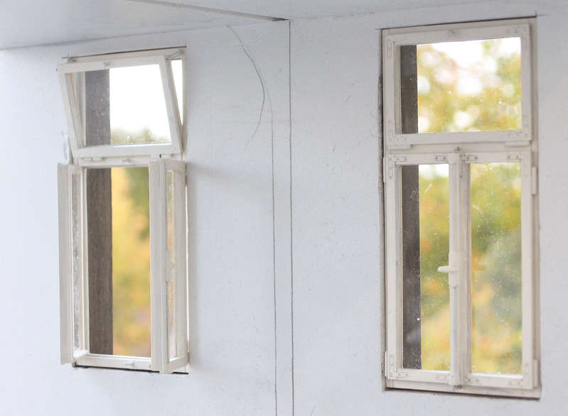

Window frames consist of two 1 mm and one 0.5 mm layers. With the additional 'glass' layer of 0.5 mm it hits the outer frames measurements.

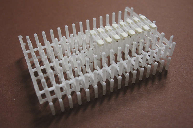

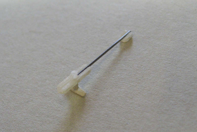

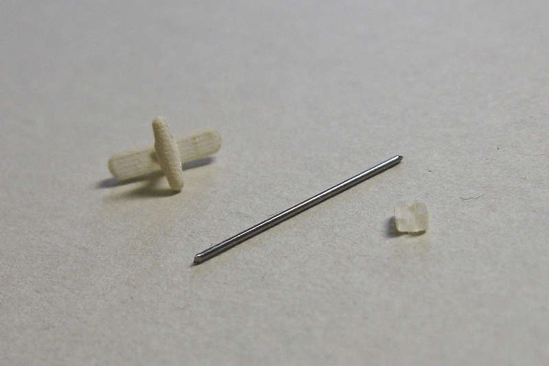

Then there are some additional pieces like the handles and hinges, which are FXD printed. Some 0.5 mm steel wire fits to the grooves to simulate the latch bars.
This is how the terminal bar guides and hinges come from the printer. Hinges are hollow and have a middle predetermined breaking point to have the opportunity to make them functional. At least one or two ...  :P

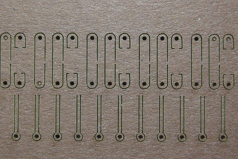

Runners, brackets and latch eyelets are lasered from thin cardboard.

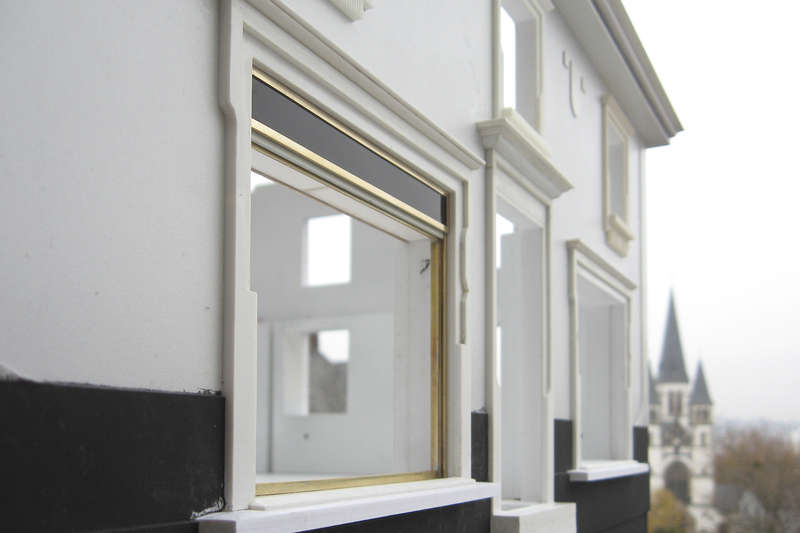

Glad I have ten of them  :). To continue complaining about first world problems: I didn't find an opportunity to have the 0.5 mm glass screen lasercut for a resonable price, that I kindly got from German Schott Glas company. I used acrylic glass instead and meanwhile I'm sure glass would have brought along a bunch of problems according to it's fragility. Well, the screen is packed in a huge (repeat: huge) parcel right behind my desk and I'm afraid I'll have to dispose of it  :-\. Modeler - clutterer - what's the differnce?

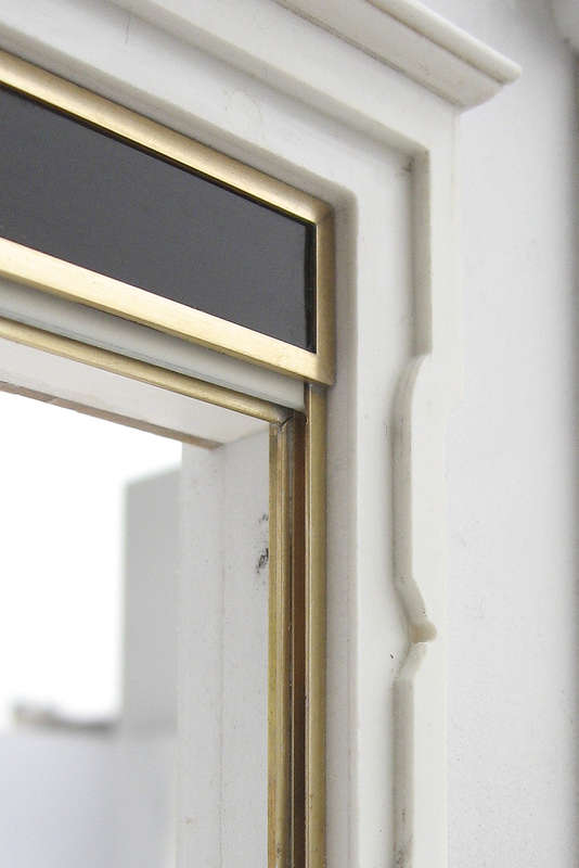

One of the shop windows seems to have been replaced for adding a shutter. A good opportunity to work with that 50s' shop windows appearance and shiny brass. The upper screen is painted black on the back, Jack. The big one won't be installed before finishing all the coarse work at first floor and facade.
Hi Volker,
there should be a roller shutter in the roller-shutter box, which you can lower.
That would make this great model incomparably.
