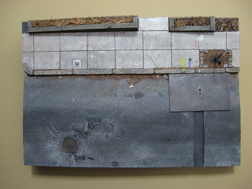

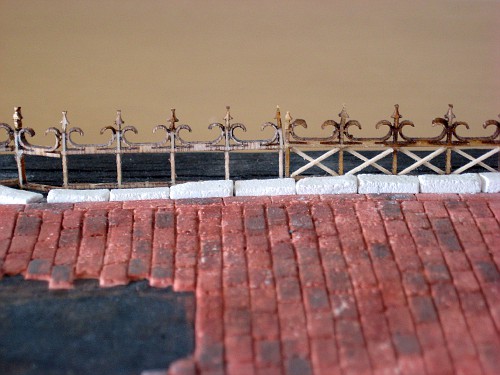

Very clever reuse and adaption of the dollhouse fencing...
How did you cut such a fragile assembly? -- Russ
nk
Russ, Soaking the parts in superglue before cutting was the key, it soaked right into the wood and consolidated it so that it was no longer brittle. I tried a few methods which involved masking tape as an auxillary support for the pieces, but it turned out that squeezing the parts between my fingers worked best and then I slowly cut with a razor saw foll. Once cut I placed the part onto some masking tape and smoothed it with an emory stick. It wasn't perfect but it worked pretty well.
If I were to do it again, I think I would make a set of CAD drawings and make up the parts as a photoetch sheet...the beauty of 20/20 hindsight....

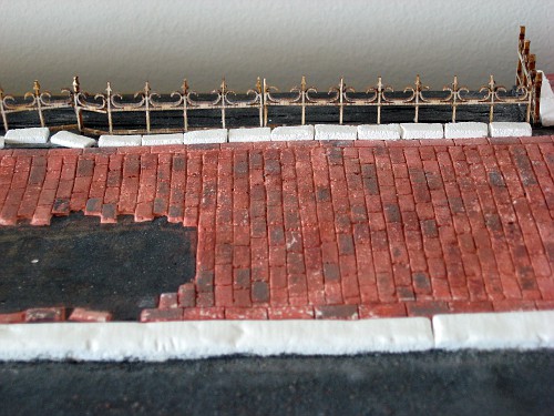

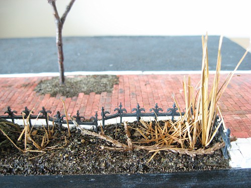

I tried out the edging on the garden and compared it with the little crosses (right)  and without (left)
and although the crosses are closer to the prototype, they didn't look as good, so out they went and the edging looks like this now:
I just need to paint them and glue them in place permanently.

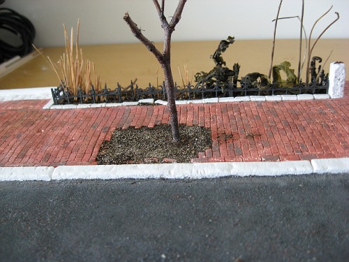

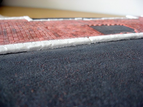

I added the kerb stones. This took a lot more work than you may first think. The stones are long and thin and I wanted the snapped look of the granite prototype on some of them. So I cast plaster slabs, scored and snapped them, and eventually got some that didn't break. I also wanted some very worn ones too and I achieved this look by applying a plaster slurry to build up the lumpy look of a worn kerb.

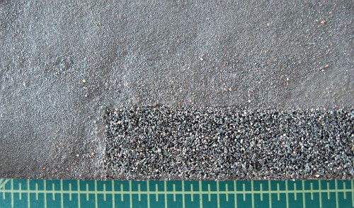

I also applied "asphalt" to the street. To do this I glue down several layers of silicon carbide of various grits with Elmer's white glue. For the patch I masked it off and added a "fill" with a different mix of asphalt and ballast.

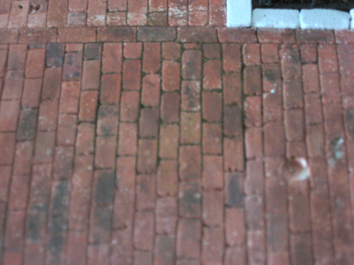

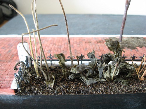

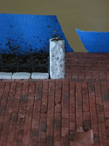

I had a busy weekend with the model. I made the tall fence post and simulated spotty granite by scraping a 6B pencil lead over it and pressing the lead into the surface with my finger. I think it worked pretty well but we'll see how it goes when I apply washes to weather it.
I also used very finely ground tea leaves to add as debris between the bricks. I used a mortar and pestle to grind it up and I pressed it into place my my finger.

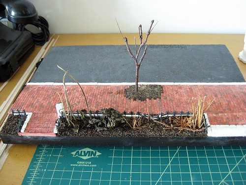

And lastly I had a lot of fun with the garden. Its not finished, I still have a lot of debris and a garden hose to add, but I let myself wander off the path a little here use some artistic licence...especially as I cannot stand gardening, so I had to keep it interesting. I used dried green-tea leaves, geranium leaf stalks (These look very triffidy to me), dried grasses sliced up with a scalpel and bits from a pine tree. The tree is a weed I found in the garden and I reconfigured it a bit.
