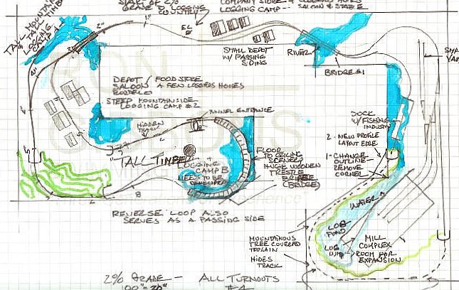

Jacq, here is the plan of the layout that my friend Peter drew and we hashed out for quite a few months. Shelbys will go where it says dock with fishing industry on the right hand side. Pat
Pat,
what is the scale of the plan and what are the dimensions of the room. Or what is the size of the squares in the plan ?
I like to get an idea of how close together your  different "scenes" are. What scale are models and trains H0 or O scale ?

  I make a sketch with some alternative positions of the area where you plan to put the wharf.

Looks like it will be a nice layout...I like that you have a good amount of "open space" (no structures) gives the sense of greater distance.  I will take a closer look at the part that you requested...but I do have one comment right off the bat....this is something that I see on many logging oriented layouts, and it really annoys me.......an those are tunnels.....VERY few if only and handful of logging operations ever had tunnels...so they really do not make any sense to me on a logging layout.  I understand the ones you have in the corners, as they are for practical purposes, ....but the one by th e trestle bothers me.....if you are using it as a scene seperator, I would say maybe consider just doing much denser forest on that mountainside, with tree canopy/limbs overhanging the right-of-way...this will give the "sense" of a seperation (tunnel) yet have that look of heavy old growth forest......much more realistic than a tunnel.
I am also not quite sure how that whole tunnel and log pond issue will look/resolve itself...they seem to be two contradictory items.  I would maybe consider some way of bringing the log pond and mill forward...so the pond hits the edge (like in Jacqs scene)...and figure out another way with the track loop.
Marc makes an excellent point and it deals with one of my pet peeves: I HATE the mindless use of tunnels as scene dividers, to hide return loops, as an ubiquitous scenic element that has no apparent reason for existing, and for any reason other than to get through a rock or mountain that must be there. Every idiotic layout I see in Model Railroader or MRC has an unnecessary tunnel or two. Every idiot uses a tunnel to hide his "staging yard". (Let's use the real, unpretentious, term: storage tracks.) Is it never possible to hide those tracks behind a hill or a dense stand of trees or even some structures?
Tunnels can be interesting, even dramatic, scenic elements. I wish more hobbyists would use them with intelligence and good taste.
  The points Marc and Russ brought up, are points that are bothering me too.  Even to such an extend that I am working on alternatives, including a good place for the wharf, keeping the character of the layout intact.

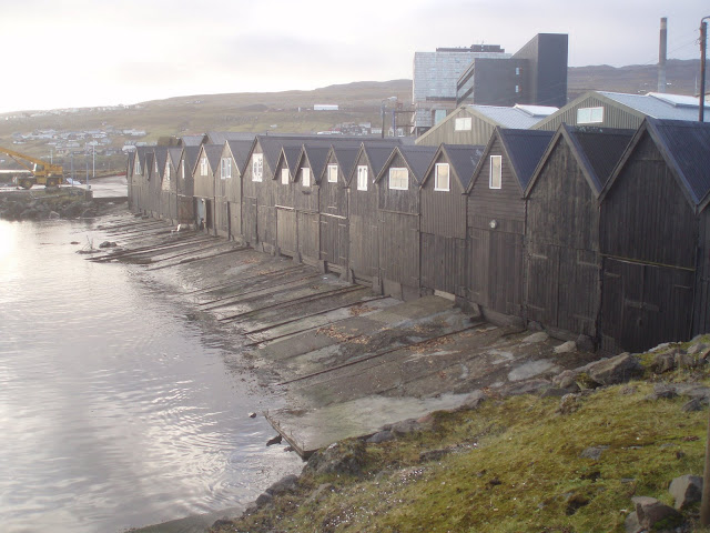

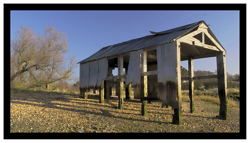

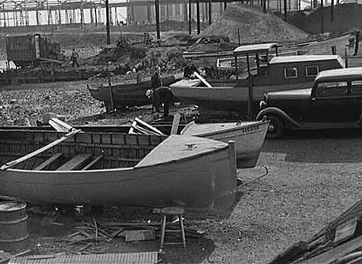

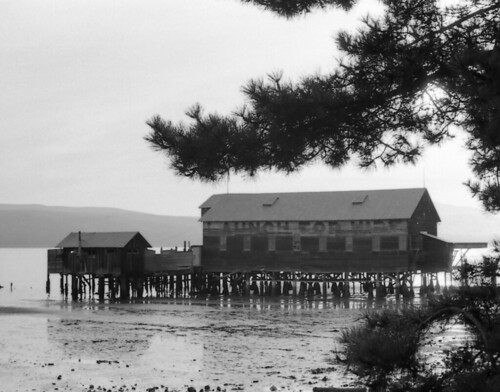

I do think you should have some additional small structures in the scene...to sort of crowd the the larger ones....then I realized something else that I think is not helping your scen...the piers/docks, their shape and the height of them, and the building locations above the "water"  why are both docks these snubbed flat ones...why cant one be the snub one, and the other be a long narrow one that extends way out into the water? maybe even with a structure on it or near the end?  And why are both buildings and docks at exactly the same height?...a building could be right down at the water line, or be nothing more than an open shed, or it could sit sideways to the water, or askew.......
Look at the images below.....not perfect examples, some are better than others, and a few far to decrepit or modern, for what I am getting at...but by looking at all of them and taking it as a whole, maybe you will better see what I am geting at in terms of these above items, and the general feel/mood of stuff.
