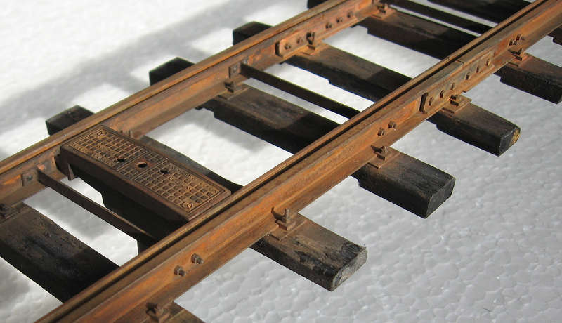

Some veneer strips served to thicken the ties. I followed your hints concerning the end grain, the too square shape and the brightness at the sides. I used a sanding disk for the shape and a very slowly turning miniature wire brush disk with the drill for the grain. Those pics were taken under a cloudy sky; I think they match the color better than the last ones under artficial lighting.
Don't mind the faces with the visible edge of the glued on veneer. It's nearly invisible from the sides.

I worked a bit with color to achieve a unifying look.
Left hand of the soldered part is pure rust, right hand the colored area:

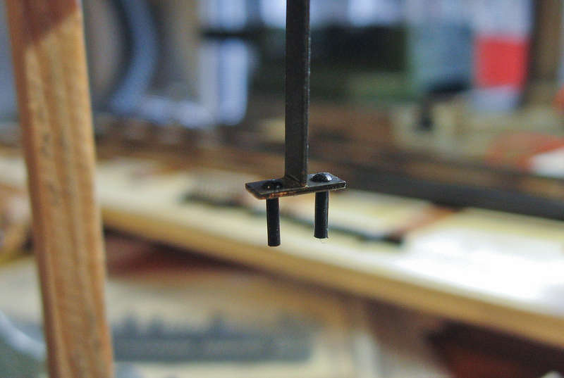

Insulation was made with a single layer of tissue paper, drenched with CA.
Some plastic rivets serve as screw imitations. Unfortunately they are a bit too thick for the M1 washers so I had to counterbore them to 1 mm.
So there are no visible threads, but it doesn't matter: At the prototype the screws end with the washer so I will shorten them.
I'm looking for a matte lacquer / fluid to fix the pigments and watercolor and to stop furthermore rusting. Any suggestions?

It is a pity that you have to lacquer the track, although I understand your approach. I also fear that all those wonderful small rusty blotches on the rail surface (they look like dried up wet areas - simply breathtaking...) will disappear after that  :-\

I cannot believe you were able to do that with paints, stains, and powders. An absolutely superb finish. Most satisfactory. -- Russ
