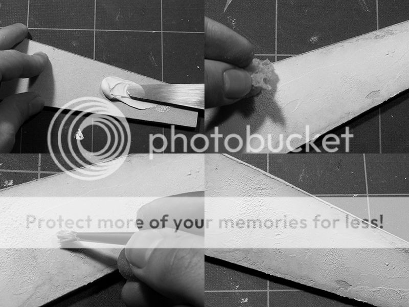

I've had convincing result using Gesso. That's basically acrylic medium, the one we use in fine arts to prime canvas.
What I like in Gesso, over other textured mediums I've tried, is its subtle and very versatile texture.
It can be worked to a dead smooth finish to virtually any grit.
For you very effect : I'd use gesso over heavy cardboard, and do a stippling job with a soft stencil brush.
I may find pictures of my experiments with gesso somewhere if you want.

So here we go. Excuse the random quality in pictures but some of these projects are old (most of them I don't have anymore).
I don't have the exact finish you're after, but this is some exemple of what you can super easily achieve with cardboard, cork, gesso, and some different texture brush.
As said, in your case, I'd recommend a stencil brush and stippling.

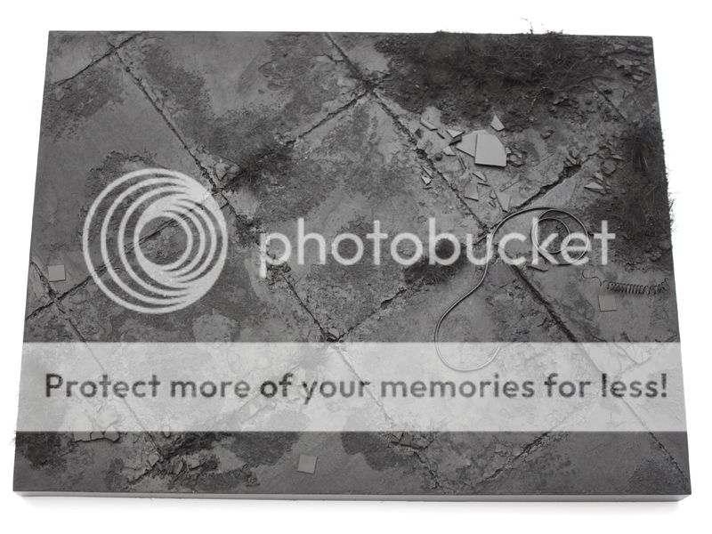

These slabs were textured that way. It's done to simulate concrete, but in some spot you can see the stippling texture :

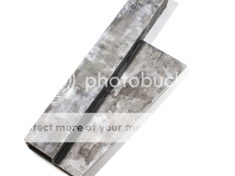

Same thing here : You can see some of the ground texture between the rubbles.

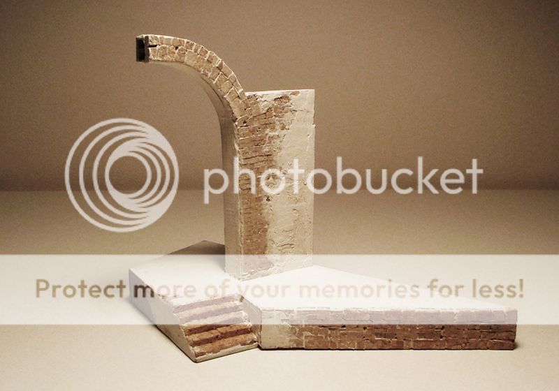

This was one of my first modelling project ever from 2007 or so. I see so many errors and failures everywhere in it now but for our concern we can see the gesso over the bricks on the right.

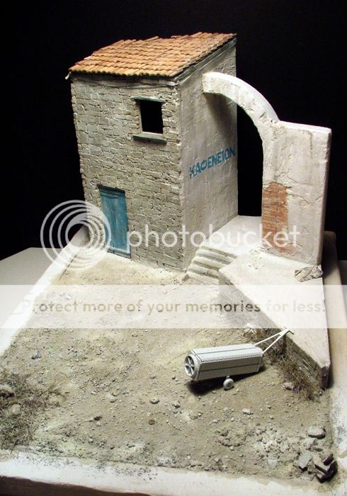

This was my first serious modelling project in December 2008. Before that I've had only painted a bunch of Warhammer figures (nobody's perfect and before going to the corner for the rest of the day I swear I have not touched a Warhammer figure again since early 2000's).
I've scratchbuilt this cretan Kafeneion (café) with cork and cardboard.
At that time, I wasn't concerned about these bricks pattern and if you look at it you just understand an house can't be build like that.
BUT BUT BUT I wasn't as lazy as I am now and it wasn't a problem for me to cut, sand and glue thousands of cork bricks and shape all the tiles from heavy paper.
Anyway, a sunday gift for you dear all, let's fire the flak on this one, I've got my parachute...
