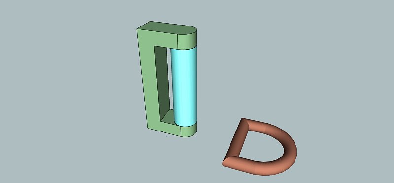

I sketched up this quickly .. yeah .. I know .. a ring through a pin would require a straight hole in the pin and a straight portion of the ring but the example shows a curvy hole .. just for fun.

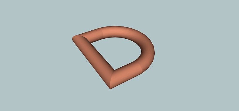

Ok. If I show how to align .. there are a dozen other ways .. this is just one
Suppose I had a cylinder and a D-ring
I decide I want to insert the D-ring into the cylinder at an exact point ..
First zoom in on the D-ring
Sketchup menu: View -> Hidden Geometry. Spin the D-ring around so you can see the straight side. There is a dotted line center. Great. Draw two lines vertically from the ends of the dotted line and then a line connecting them. (You can skip to just drawing a horizontal line but this example shows better this way. This gives you a horizontal line dead center of that straight section of D-ring.

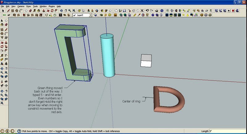

Hit "L" for Line. Hover over the center of the line you just drew. A blue dot will appear .. this is the center of the line. Now, draw a line out from that on the red axis (in this case)
I went back and turned off the Hidden Geometry. Now .. we have the D-ring with a line dead center. I grouped the line and D-ring so it's happy. I moved that green c-shape back 5 inches. I simply select the group .. hold down the right arrow key to constrain movement to the red axis .. and moved it .. typed in "5" and hit enter.
zoom in so I can see the pin. Hit "L" for line. Hover over the edge of the circle. You will see a purple 'dot' which means Sketchup knows you are wanting to work with that circle ..
now .. move the cursor to center of the circle and a dot appears dead center. Hovering over the circumference did that.
Now .. you can draw a line out from the center of the pin on the red axis. I didn't show it but you can use the tape measure too and measure the length of the line for later if needed. This line is centered on the pin .. and even with the top of the pin .. places you can measure from or to if needed.
Using the tape measure tool .. I click that line I just made and dropped a measurement line down 2.5 inches. It makes a dotted line for me.
I can now drop a line from where the one on top crosses the circumference of the pin down to that dashed tape measure line
Now I can draw a line out from that last point on the red axis. This gives me a line .. center of the pin and down 2.5 inches exactly.
I used the eraser tool (E on keyboard) and got rid of the excess lines and clutter. Now .. hit "M" for move .. and click the end of the line extending out from the D-ring. You can now drag the D-ring wherever you wish .. connected to that point. (note. You can also use the tape measure tool to measure the length of that line for later use if needed)
In this case I dragged the D-ring by the end of the line and it 'snapes' to the line out from the pin.
From this point .. you have control. Hold the "right arrow key" to constrain movement to the red axis. If you measured the lengths of the line from the pin (to center of pin axis) .. and the length of the line from the D-ring .. you can move from this point to the left .. type in the distance you want it to move .. and hit enter. You just moved it exactly where you needed to. When happy .. delete out those control lines.
If you hit "M" .. and then clicked where the line comes out of the D-ring you would be holding the D-ring at that point. If you then hold the 'Right Arrow Key" down to constrain movement to the red axis .. you can drag the D-ring inside the pin .. keep holding the left mouse button down .. (you clicked on the end of the line and moved the mouse (constrained on red axis). You can now move the cursor up .. since the right arrow key is held the D-ring stays constrained to movement on the red axis ..  but you can hover over the center of the pin. The point you are holding aligns vertically now on that center.
Let go of everything. Now .. say .. you want that point on the D-ring back (to the right) .75 inches. Ok. Hold th right arrow key again .. to constrain movement .. move the D-right back a ways .. let go .. ener .75 on keyboard .. and hit enter.
