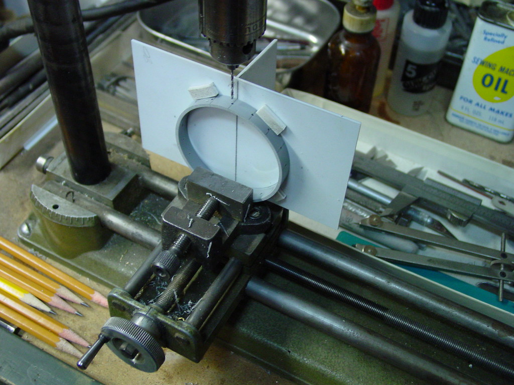

This is my first set of spoke wheels I used 2-1/2" Plastruct tubing for the front wheels and 3-1/4" Plastruct tubing. For the rear wheels. I first draw a circle and divided it into 18 segments. I use this to mark the wheel along with a small square.
The jig is made up out of styrene and goes up against the fixed jaw of my vice with a stop to keep it from moving from side to side. I added four stops on the front to keep the wheel in place  with a center line to line up the drill-bit. I also added one stop on the inside of the wheel at the top to keep the wheel from collapsing when drilling. Now I line up the mark on the wheel to the center line on the jig, and tighten up the vice and drill. After the hole is drilled loosen the vice and move to the next mark. This jig is only good for this diameter of tubing, so I will need to build another jig for the rear wheels.

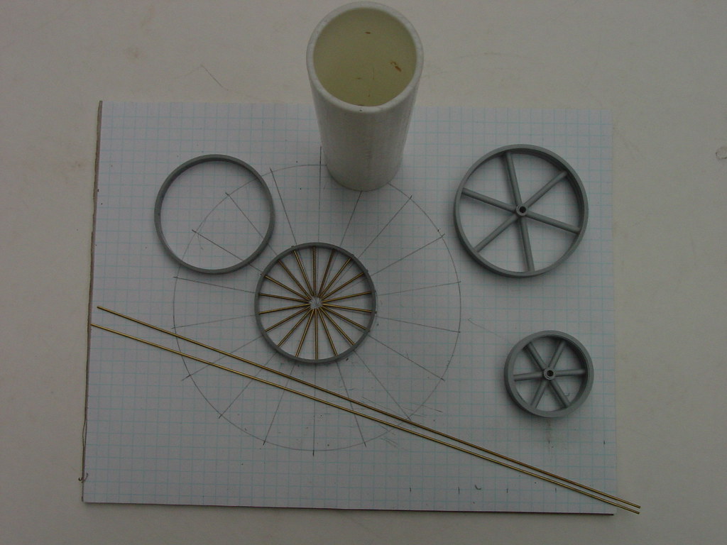

The pulleys are made from Plastruct tubing  with the spokes made up out of three layers the center disks out of .020" styrene and 1/8" half round  styrene  on both sides. All of the styrene is from Evergreen Scale Models. This gives me a 2" spoke where the prototype are a little larger.

You have revealed one secret: You have some machine tools and don't do all that perfect work by hand with a file and a drill. Now I feel about 1% better. -- Russ
He has a lot of neatly sharpened wooden pencils too.  ;)  -- Dallas

Thanks guys for your comments. The Unimat is a SL 1000 that I got in the early 70s. The motor is getting old so I don't use it for any heavy work just light work

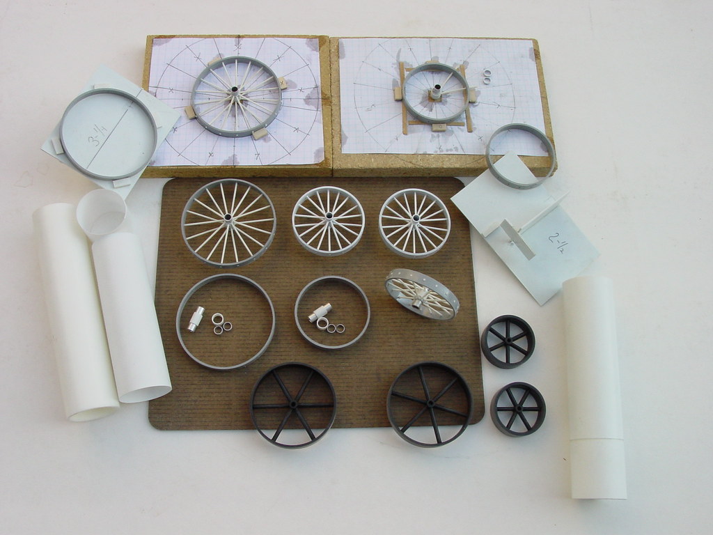

This photo shows the two assembly jigs, the two drilling jigs (one showing the front-side and one the back-side), the boiler core with the first styrene wrap. The two wheels that have been primed are my first design and will be used on another project or use them for clutter. I modified the hubs on the second design to help hold that end of the spoke. Using liquid plastic cement, the wheel doesn't get stuck to the jig. After I remove the wheel from the jig, I add a small aluminum ring on both ends of the hub I use a thin CA  and let it run around the spokes. Also at the bottom is two sets of pulleys.
That's one picture worth a thousand words. -- Russ
You make the (black) pulleys the same way?
What holds the spokes in the hub? Drilled too or just glued.
great pica btw!
mj
#13
The pulleys are made from Plastruct tubing  with the spokes made up out of three layers the center disks out of .020" styrene and 1/8" half- round  styrene  on both sides. All of the styrene is from Evergreen Scale Models. This gives me a 2" spoke where the prototype are a little larger.
I made these pulleys the same way I made the gears and pulley on the Buffalo Pitts engine.
http://www.finescalerr.com/smf/index.php?topic=1634.0
1- Cut a disk out of styrene and mark the spokes. (I cut the disk a little larger than the tubing and sand it down to get a tight fit.)
2- Drill a hole for the axle and add one side of the hub.
3- Add the half-round to the same side.
4- Cut out the disk between the spokes.
5- Turn over and add the hub and half-round.(The half-round pieces are cut a little shorter so the center disk is the only part that goes into the grove.)
That last photo is fantastically information.  The oblong spoke technique is definitely a keeper.
Thanks so much for sharing such great information, Gordon.
