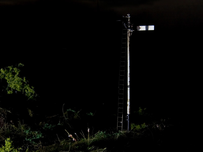

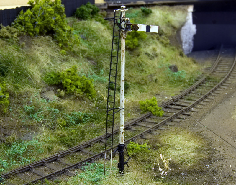

I've always liked mechanical signals, the ones on Moor Street are great fun to play with but for New Street I wont get the chance to have any.  However for Brettell Road there are 2 (one of which is abandoned) so I have got to have a go at making some from MSE kits.

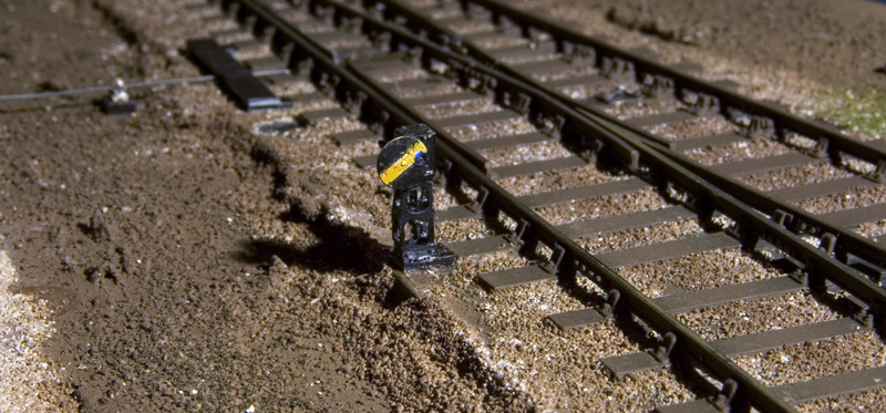

First up the disused one, based on a photo I found. This one would actually be a repeater for the main signal the other side of the bridge due to sighting problems. Weathering is done with gouache. I replaced the supplied ladder with one of Colin Craig's.

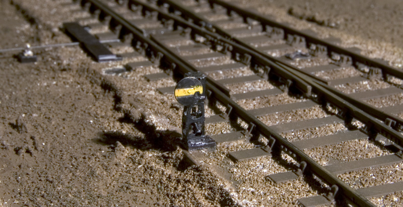

The other signal is this little ground signal (yellow so that the headshunt can be used when its set to danger) I deviated from the MSE instructions by making the counterweight arm work too. Theres a fibre optic in the lamp but its a bugger to photograph - you can just make it out in the second picture. It looks a bit blue but I was using a white light source - changing it to a yellow one should correct this.
Finally as I was tidying up I left a pack of LED's lying on the layout and purely by chance it illuminated the signal. Thinking it looked quite nice I took the image below - I'd like to claim it was carefully planned but nope - this was just lucky!

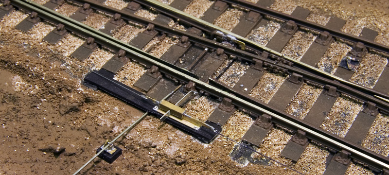

What you see above is a representation of a detector for the ground signal on Brettell Road. It was knocked up from scraps of brass using photos and Steve Hall's articles in MRJ 113 and 115. I always enjoy fiddly details like this even though I know it will go unnoticed to most people.

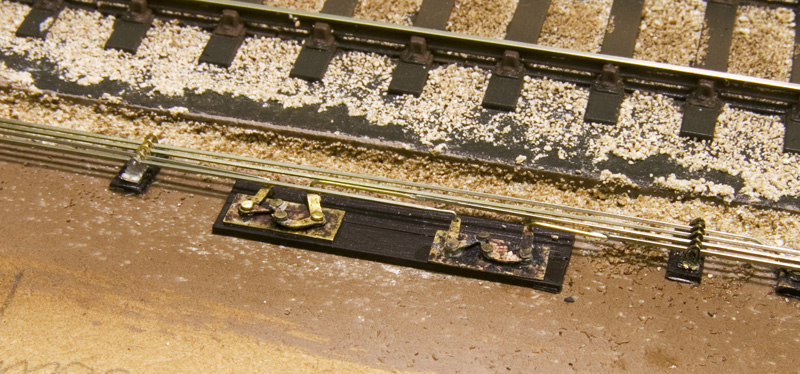

There's only going to be 1 point on Brettell Road that's operated by the off scene signal box, the rest being operated by hand levers. However I wanted to include remnants of what was there before meaning the double slip would have been operated either end with facing point locks. Also given the distance a couple of compensators will be needed so while it's not exactly complicated stuff it is worth doing.
My chosen route is the Brassmasters etched bits with rodding from MSE. I have also included the odd rodding stool where the rodding has been removed to help with the idea that it's not so much added to the layout as taken away.
Most of this stuff is quite basic if a bit fiddly. Above are a couple of compensators. The ones supplied are cosmetic and don't move and that's fine for the disused rods as per the one on the right however with only 1 run that does anything it would be rude not to make it work. Ok it's driven from the point rather than driving the point itself but let's not worry too much about that. 2 Brassmasters compensators were used to make the one on the left with the centre arm from one and a few brass pins meaning it will move when the point it thrown.
All in a fun little project see below for a quick video

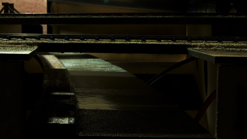

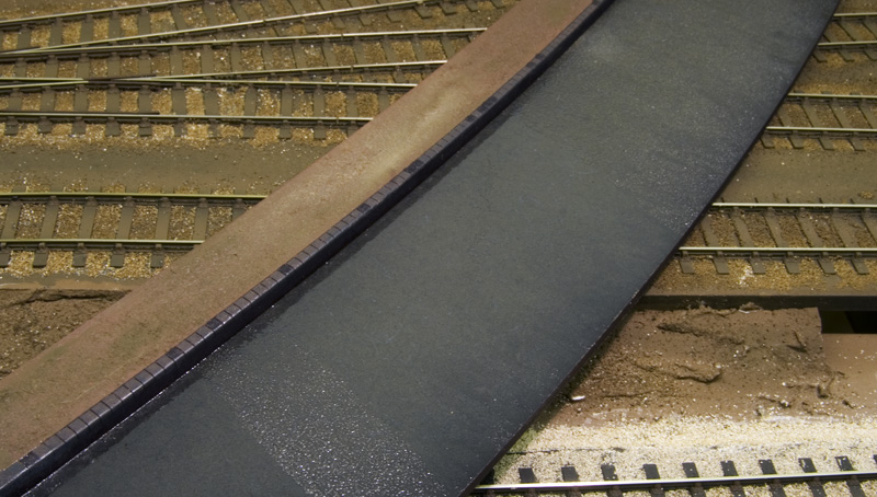

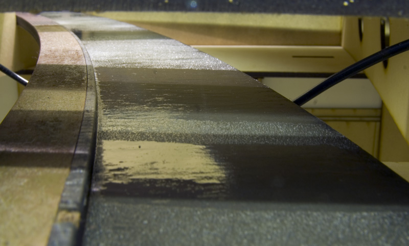

While falling rain is not doable and if it was to scale wouldn't be visible anyway I believe it's worth trying to show the effects of rainfall. Of course it will be frozen in time but I don't think there's a lot I can do about that and I'd like to credit those who view the layout in the flesh with a degree of imagination.
Aside from things looking wet the other thing I wanted to try was raindrops in puddles and the canal.
The canal itself was done with multiple layers of varnish as per Gordon Gravetts book then the area where the bridges were masked and more varnish added (Humbrol clear) with baking soda sprinkled on while wet. I did try cold and warm varnish  to see if it made any difference but found it didn't.
The above image shows the canal in position (again you will have to imagine the walls) and below in something approaching the light I plan the final project to have.
Jim Smith-Wright
Looks good to me. Especially the second shot with backlight gives a good impression of an april sunlight shower. Very interesting approach.
Very inventive technique. It does give the impression it's raining.
