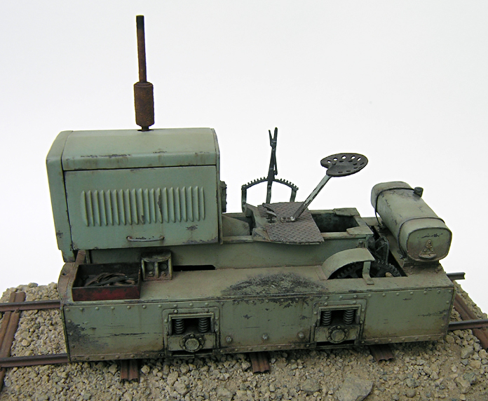

Was digging through my hard drive, and came across these images of the initial construcion of this loco....Thought I would post them just for info/reference.
The "tractor" portion of the loco was constructed using heavily modified and reshaped parts from a 1/48 scale Bandai SdKfz.-11 half-track kit, as were the rear transmission and "tractor frame". The firewall was made from sheet styrene, and an HO boxcar brake ratchet mechanism enclosure. The transmission ia part of a Grandt Line O-scale caboose stove, and the floor plate is from an HO  Jordan truck kit. The gusset plates came from a Grandt Line Koppel ore car kit.
The loco frame was modified from a Grandt-Line "Battery Mine Loco"
A new deck for the loco frame was made from sheet styrene embossed with rivets using a NWSL Sensi-press. "Mounts" for the "tractor" were made from cut down Grandt Line D&RGW coupler pockets.
Smaller details were then added using strip and sheet styrene, a PSC brake lever, brass strip and wire. Additional rivets from Tichey were also added.  The white metal tank shape came from an HO parts scrap box.

Some quick pics of the progress.....pretty much done with this, except for a small lever and it's trim detail at the left side of the firewall. I lost the damn part somewhere, and thus now have to meke one again...Grrrr!
A more accurate photo/representaion of the colors. The other 3 Images were shot while overcast without proper white-balance adjustment.

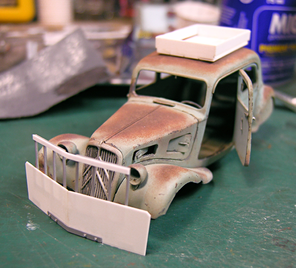

Jerry; The Citroen revival is in the works....I am currently trying to wrestle through several issues on it:  I think I am going to have to suspend "Reality" for ease of mind and sanity, insofar as as modeling the drivetrain....the real car was front wheel drive....which would be OK if I model the car with four "rail wheels" in the same loc as the road wheels were....but I am sort of feeling that two rear wheels, and a 4-wheel front "truck" look more interesting.....but this means that the model would now be a "rear wheel" drive.....not a huge issue in "pretend model-land", and most modelers would probably not even know/notice....but I need to come to grips with it.  The other items are "wheel design"...I need to scratch some wheels that I feel look interesting and appropriate......and I am also playing around with the roof and guard details shown in the photo below...to make sure I feel happy with them.
