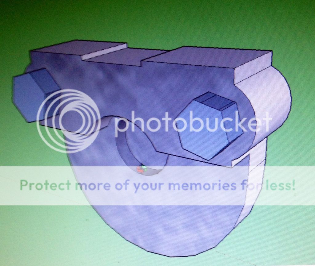

This is what a couple hours of playing with SU produced.
Looks good but i have no idea how to"place" the circles and holes exactly.
* And then once I get it drawn how do I know if it is "right" without actually printing it?
* I have been using the dimensions tool so I guess thats the only way?
May be i can find some videos today after i do some real modeling.

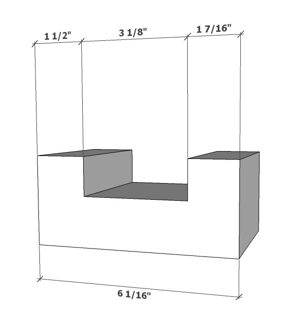

I was checking dimensions so I could redraw this for (hopefully) the final time.
And notice what seems like an error to me.
How could a computer program make a mistake like this or am I not "reading" this correctly?
I was using the "dimension tool".
Somebody more technical than I will explain "how" but I can tell you that smaller errors are common in CAD programs; for example you draw something 1.0000 inches long and next time you check it the dimension is 0.9977 inches. Yours is a more significant discrepancy and one of our resident geniuses no doubt can account for it. -- Russ

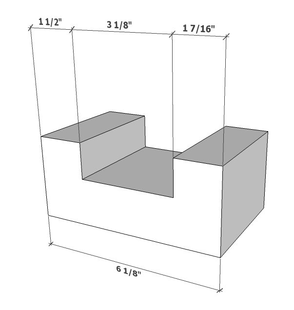

I did a quick drawing using your three dimensions and got this ..
A look at the Model Info ..... Window >> Model Info shows me that it is set up as:
Format: Architectural
Precision: 1/16"
Enable length snapping: 1/16"
I almost never use this for anything other than buildings. Instead I use ..
Format: Decimal
Precision: 0.000"
Enable leng snapping: 0.000" (sets automatically when I set the Precision)
which gives me this ...
What happens is when you were set to Architectural it was set to 1/16" (in my case at least) and was snapping the dimensions to the closest 1/16". Now we can see the exact dimensions.
A little pushing and pulling gets the three dimensions to what you entered and the overall length is now correct.
For a check switch back to Architectural ..
