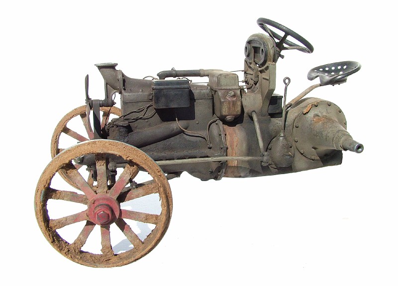

Haven't had much time for modelling lately...still re-working the die cast bits.

Beautiful work my friend, kinda makes me wanna trash my stuff and take up basket weaving...............Mac McCalla

Mac, when I were nobbut a lad I did quite a lot of basket weaving.  Gave me cheap Christmas presents for grannies and Mum.  She still has them 45 years later!  Then I discovered modelmaking.  Chuck's stuff IS lovely , ain't it?  I like the way it looks like he almost doesn't care. It just rolls off his thumbs.

Some progress:
Working on the gas tank and radiator now:
My God Chuck you have just set the standard for anyone who ever builds a tractor.
The more I look at your work the more I shake my head in total amazement.
Your talent is beyond words!!

Here is my hopefull plan for the radiator. Fins from .002 Mylar, tube spacer from laser cut clear .010 mylar. Still in the testing stage, we shall see! (standby for plan C)
Fin/spacer assy
The core assy

Since the spacers are solid, I am assuming, that you won't be able to see "daylight" between the fins?
Did Tom cut these parts for you? How clean did the Mylar cut?

I am thinking the clear Mylar spacer will potentially allow a ?see thru? effect, and I will just paint the tube ?bumps?. All has still to be proven as Tom didn?t have .010 Mylar. I have some on the way, hopefully this will work!
If for some reason I have to give up the see thru, I won?t be unhappy. The Fordson core was quite thick, and out of the hundreds of pics I have collected for reference, maybe only 2 show any hint of light peeking thru, and these were taken square on.
If all else fails, on to Plan 9!
Interesting idea Chuck. How are you planning to register or align all the separate layers?
Bill
Probably some simple tooling that I will butt everything up against. Notches were considered, but we'll see if the part can be made. Crossed fingers....
Since you're planning to have the spacer pieces laser cut, could you not have a couple of holes laser cut in the middle of the stock in-line with the "bumps" for alignment pins? Then you'd just have to stack the pieces in order by dropping them over the pins. Just a thought....
