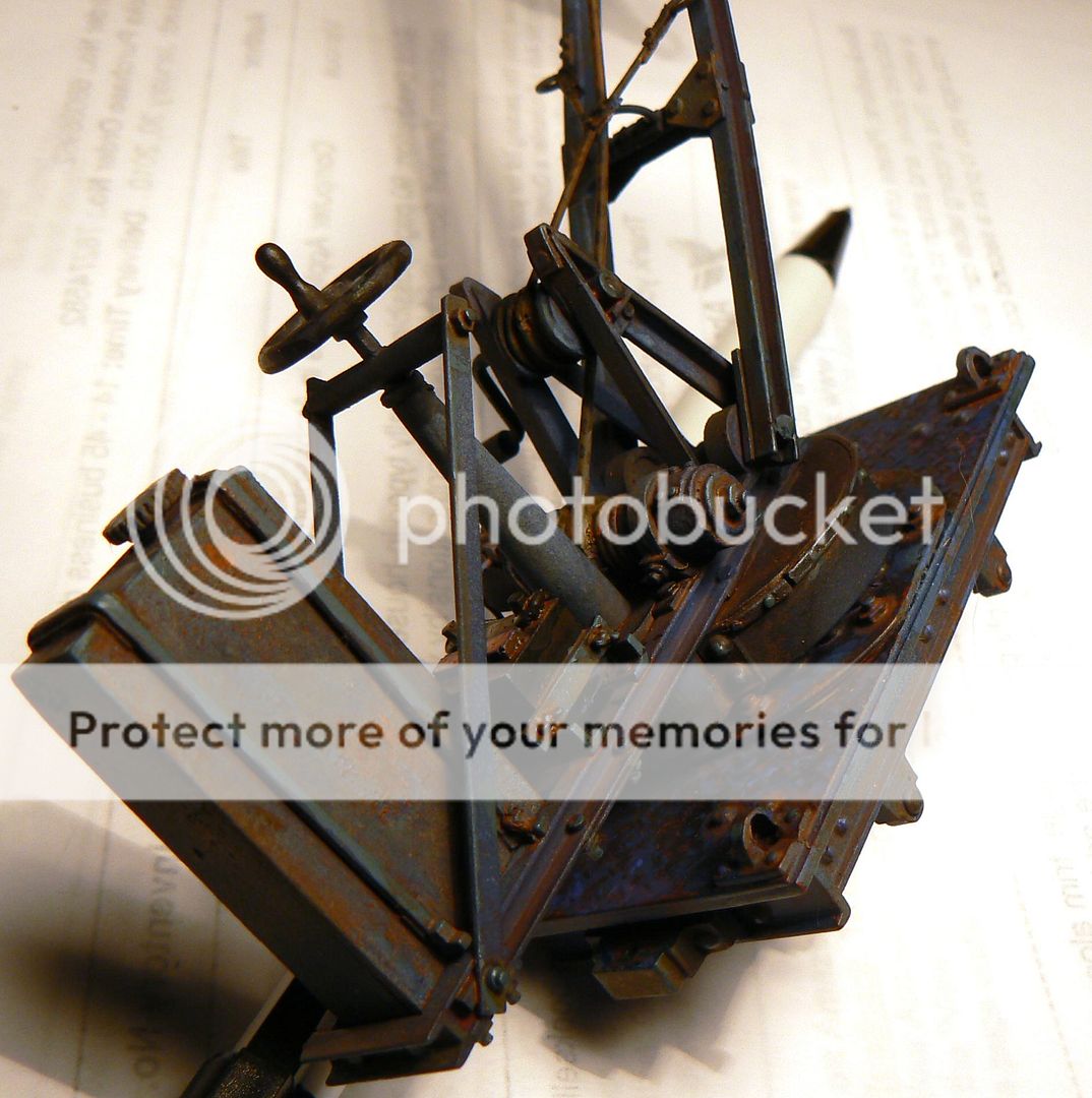

One photo to show where I have got after further filters and some general washes in an attempt to bring together the ballast tank and the rest of the crane as per Jacq's comments
Any comments are welcome as since my previous modelling experiences the paint materials and techniques have certainly expanded and the more thoughts and direction I can get will be a great help.
thanks
  Gordon,
  the top of the battery should have no rust..... Same for the parts of the electric motor.  This looks imo a lot better, but still too shiny. Do you plan to add dirt and dust?
Thanks for the feedback Jacq.
Again your right, will sort out rust on battery tomorrow ..... probably will tone down rust stains on electric motor, it is made of steel so happy to justify some rust!
Haven't done any pin washes yet so next stage will be a satin coat, pin washes and then a flat coat to kill any gloss.
Like the idea of adding some dirt just not to sure how to do it yet?
Keep up the critique ... its like being back university again  ;)

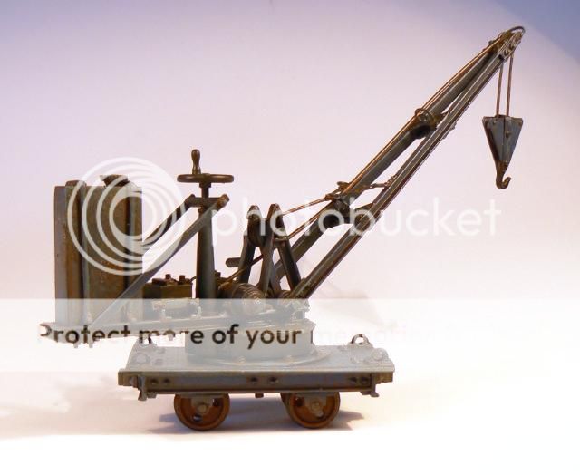

It looks beautiful, although I agree with the points made by Jacq. Take care of those issues and you've nailed it, imho.
For me, FWIW, right now (last image)
I think it is to monochromatic.
There should be some subtle color and texture variations.
At the least with the cables (should be somewhat silver if in use) and other materials.
More so the color bothers me, sorry it is just too much of the blue.
I would usually offer some more recommendations when giving negative feedback
Right now I dont have any more or the time to offer some visual clues.
Not having an exact prototype here does not help, but some of the images might be of an assist.
I know you can improve this up to the level of the build!
Hope this helps :(

Marty, been sorting out my lighting set up ,this is slighty more accurate and not as "blue"
that shot is better!
