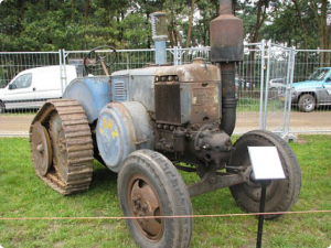

Whist cleaning up the bits , and little clean up is really required as it's a lovely little kit my mind turned to what I could do to the kit to make it a bit different. A little research turned up this , a Roadless Track conversion ..... so an iconic German tractor with an English company's conversion , developed by a man who had worked on British tanks in WW1 .... seemed a nice twist
OK obviously I was getting too smug over my ability to post pics ....... can somebody tell me how when you have added a photo that takes you over the 230 limit you can delete a photo , I could not find out how and have had repeat the whole process !
So here are the other pics of the real life one

I had no info on how the real life version fitted the track units on, so my work is at best educated guess work combined with research on similar conversions to Fordsons and my supposed knowledge as an ex mechanical engineer
