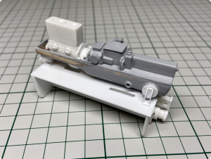

I don't have any in progress shots of next stage , so you are just going to have to take my word that all the transmission , steering box humps and bumps were all just pieces of scrap plastic tubing, square and round added to try and look like some reference photos I had found on the internet .

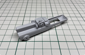

The photo shows the unit again after a primer coat, I had used fillets of thin superglue to try and replicate the "rounded look" of a cast object ( the internal corners specifically ) and the primer was applied to check this look
After this it was all just basic building , the chassis could not really be any simpler
And again checks along the way to see that I had measured twice and cut once  :D

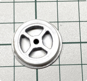

I made up a master for the wheels, as I said Barney is not to keen on solid wheels , so I deviated from the prototype here .... These were then cast in resin and the thing is starting to look like a critter  ;)

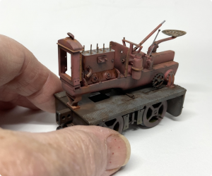

So that's it , final shots of completed .... And painted  ;D ;D
