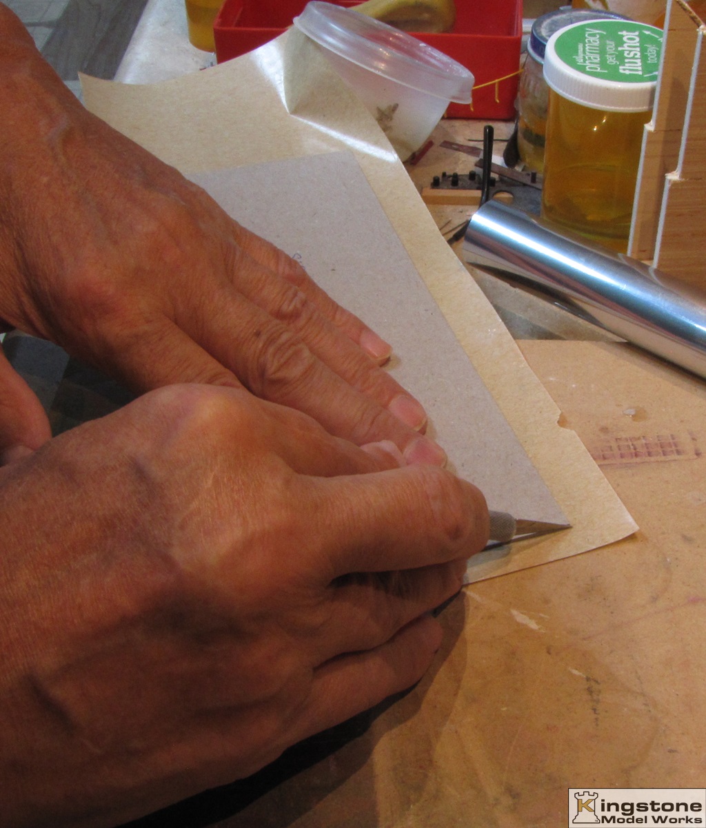

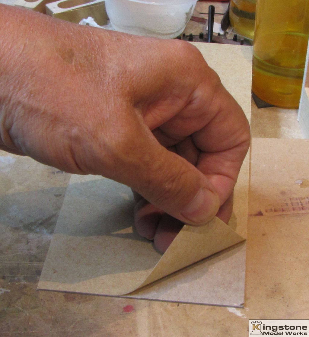

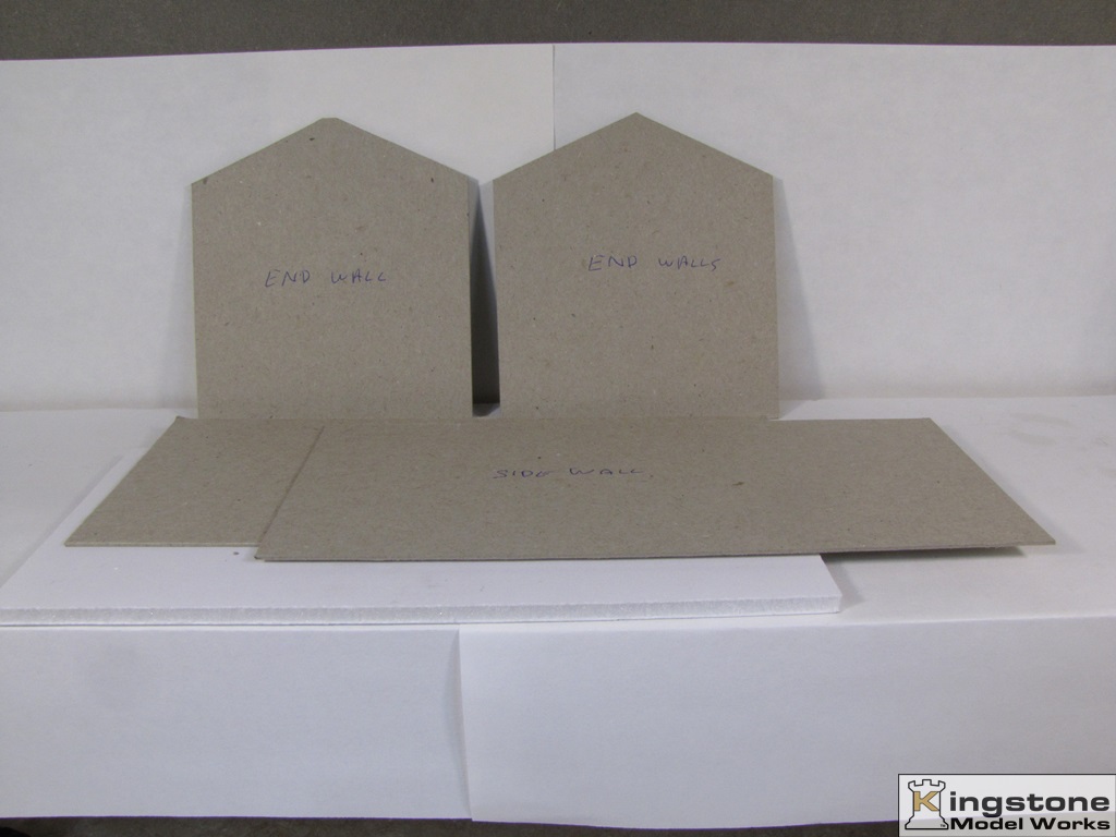

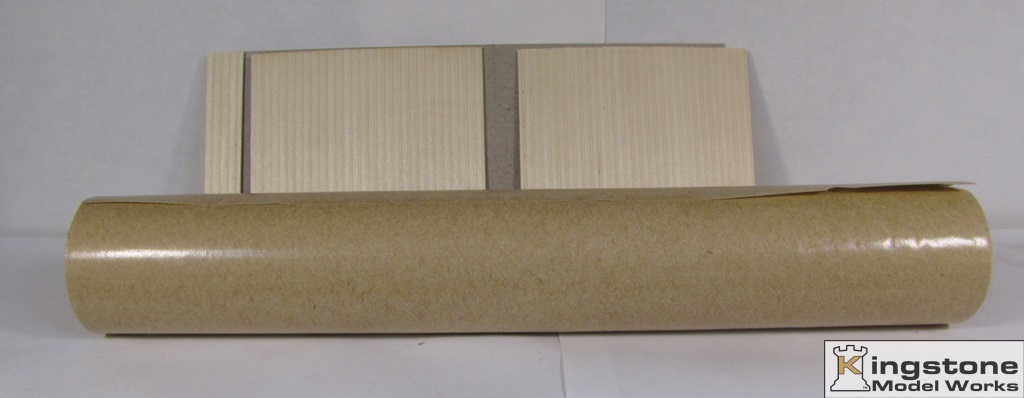

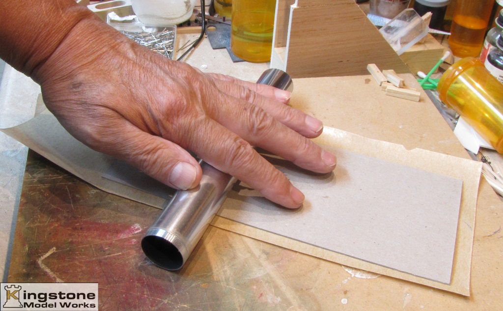

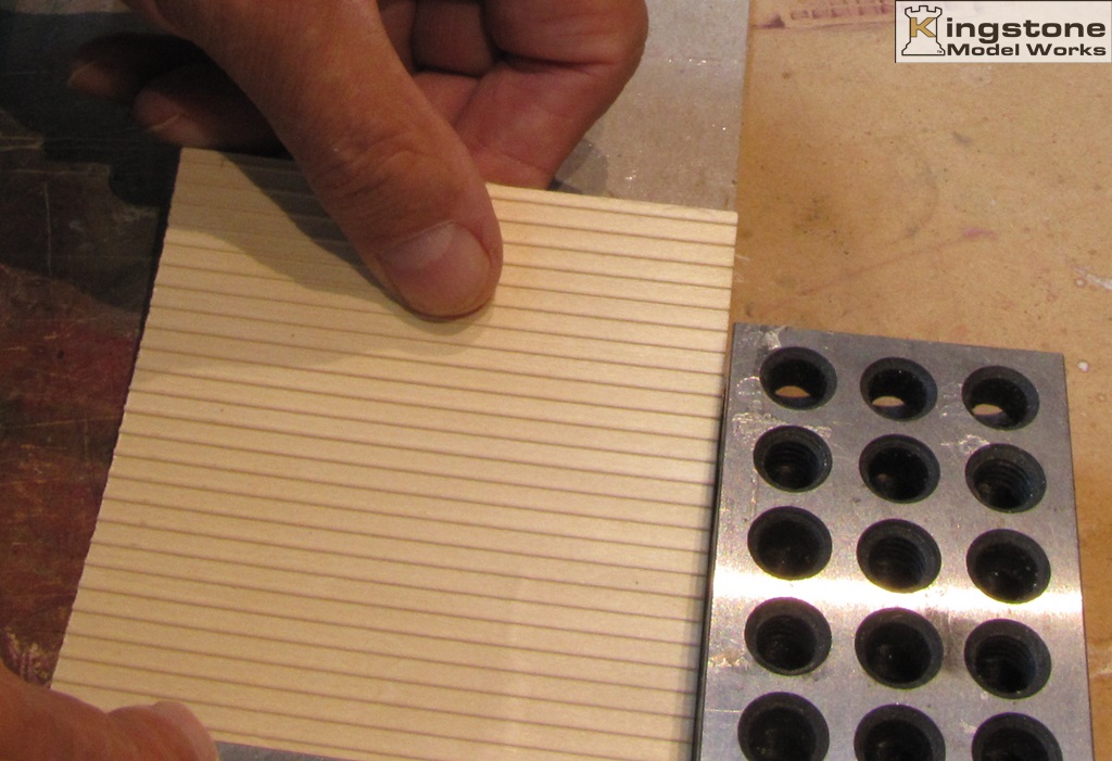

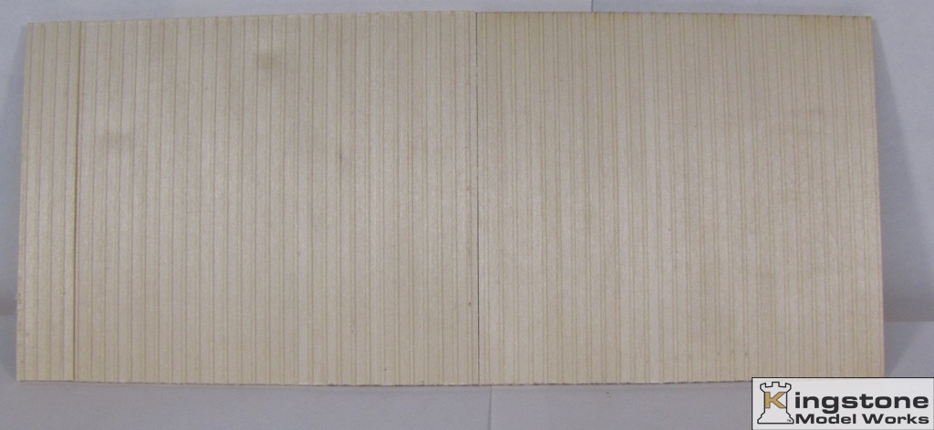

I tried the 3-M 467 double sided tape. I bought a roll from Amazon. Here are a few pictures. I laminated board-n-batten siding to a chipboard backing. Works great and it sticks too. No warping from using glue for the two surfaces.

Bernd, I learned about 3-M 467 tape from my friend, Tom Fitzgerald, who used to own Crystal River Products and produced superb structure kits. The tape is as strong as any glue and lasts a lifetime.
