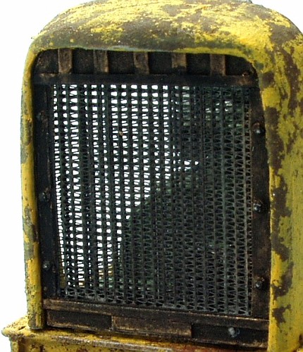

how'd you do the radiator? layers of mesh?
What technique did you use on the yellow, hairspray, salt or?.....

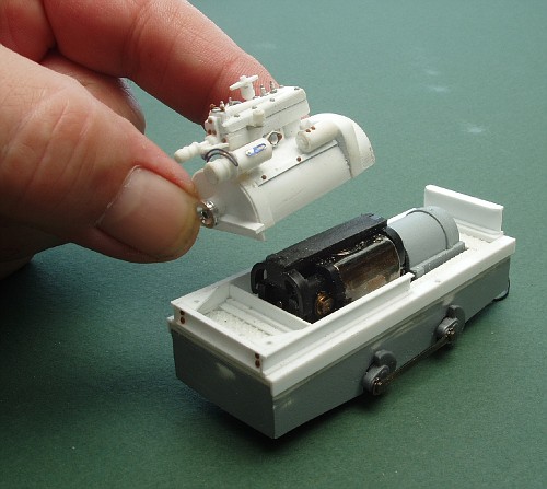

Thanks, guys:
Chuck, the motor won't be hidden TOO much by the side panels.  You'll be able to look
down from the top and see most of it:
What I'm trying to hide (or at least underplay) is the huge, unprototypically bulbous
lower portion of the engine block.
The grill was done using Detail Master 1/25th scale photo-etched "Radiator Screen".
This closeup really shows how cool this stuff is:
Looking at the right side you'll see that the cooling fins are relief etched so the vertical channels stand out.
I glued thin floral wire behind the vertical channels to give the radiator more depth, then covered
the backside with a piece of small, generic mesh screen.
The finish is:
1)  Plasti-Kote T-235 (gray) Sandable Primer (My favorite primer);
2)  A dusting of Rustoleum American Accents "Sandstone", a very fine texture paint that's right up
there with Rustoleum "Terra Cotta" on my new favorite list;
3)  Rubber cement dabbed on with a small iece of Scotchbrite pad;
4)  Brush-coat of Jo Sonja Yellow;
5)  Pulled off the rubber cement with tape;
6)  Went over the whole thing with a thin wash of yellow;
7)  The last step will involve adding flecks of dark rust here & there with some streaking, etc.
using pastel chalk dust.
Thanks again for all the comments.

Ken, sorry if I asked this before, but is this one able to run on the track, or did you remove the motor and wires etc.?
Crazy About Rust!
Quote from: Chuck Doan on September 10, 2010, 11:51:38 AM
Oh, OK I didn't remember it was going to be topless.
Chuck your embarrassing ssuR!!!!!
Ken beautiful work.
Quote from: Damn Cranky on September 13, 2010, 05:46:56 AM
......is this one able to run on the track, or did you remove the motor and wires etc.?
This one runs, Crank.  I just removed the DCC chip.
