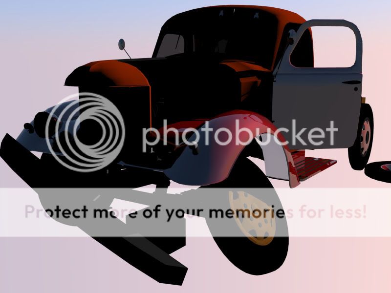

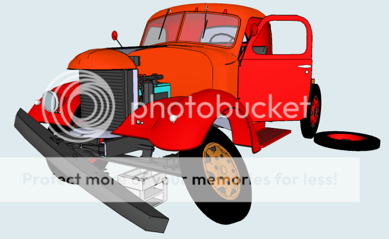

Anyone using Sketchup and wanting a better rendering engine, check out Kerkythea. It's free .. and fully capable of very high quality renderings. Did I mention it is free?
Kerkythea
Kerkythea Sketchup Exporter
P.S. It put an icon on my Sketchup that allows me to export directly to the kerkythea renderer .. pretty sweet.
Here's a 'Rusty Farm Truck' I downloaded from Google 3d Warehouse ..
As rendered and a 2d export from Sketchup (reduced to 800 px width for posting to this forum)..
As the same view exported and rendered in Kerkythea (default settings .. bumped up with higher raytracing and applied a Ferarri red paint from the Kerkythea bucket for the fenders. The rest is whatever Sketchup had. You can see though what it is capable of ..) ..

Interesting results on the render. I have had  Kerkythea downloaded for some time, but have not gotten around to trying. I guess I need to get of my but and give it a go.
Posts: 1019
« Reply #8 on: May 16, 2010, 05:55:35 PM »
If you goto that second link it will put an icon on your Sketchup's .. uhhh ... icon menu. Note that if you just use the Kerky defaults it renders pretty quickly .. the more you play with the Ray tracing the longer. There are a bunch of materials you can download .. like that Ferrari Red I painted the fender with. If you look through the examples there are some world class renderings done.
