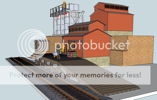

I just did this really really quickly just now.
Here's a scene from my Acme Oil Company I'm Imagineering ..

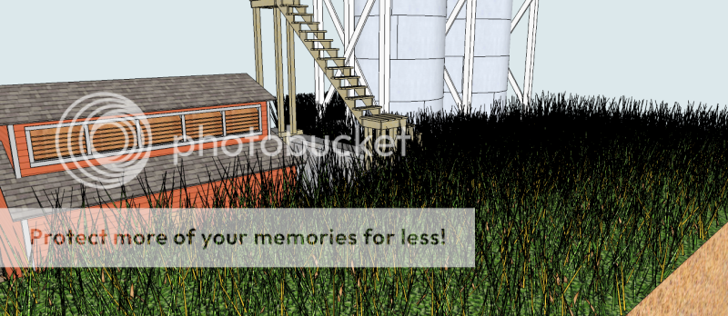

Here's the same scene (mostly .. I moved the mouse) with grass .. etc

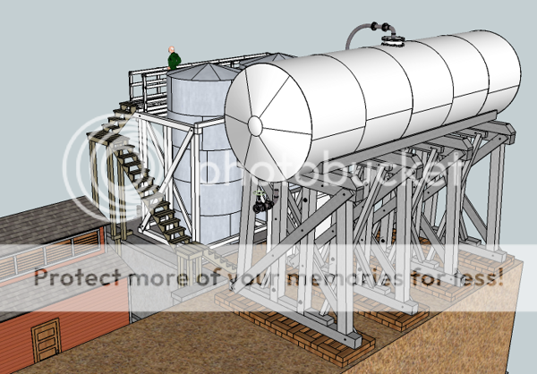

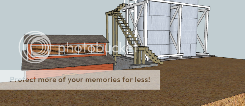

Here's a earlier version .. with two vertical storage tanks on the upper level. Not sure how that fellow got on that walkway around the tanks as I don't have any stairs yet. Ha.

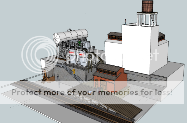

A later version .. stairs partially completed for the tanks .. my horizontal tank added at right angles to the track .. diff upper structure.
Here, I rotated the horizontal tank and moved it behind the vertical tanks.
One thing that I really like about using Sketchup in designing models is that in 3D you can see if the 'bits' don't align properly. That horizontal tank for example, I found in a book published in 1903. Trying to scale up from a fuzzy drawing having the ability to spin the object you are modeling helps make sense out of looking at a 2D elevation and front view.
