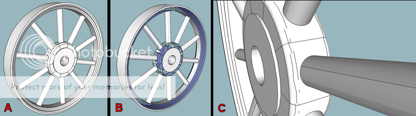

[EDIT: A quick note re the drawing set-up:
Instead of working/drawing things the actual size of the model, and having to convert all those real world dimensions into model scale dimension, you can leave the setting and draw things at the real world scale, and then come in at the end and "Scale" the entire drawing to the appropriate size......however, I prefer not to do this because I am often dealing in and drawing "model scale" plastic, stripwood or cutting dimensions.....and when you scale downd a full size drawing at the end, you may very well end up with model dimensions that do not match available material or mfg. tolerances.]
Well .. darn. Lesson's learned and all that. Wanting to explore the 'Print-a-Part world', I drew up a wheel in Sketchup (1927 Talbot) full 'real world' size. Fig A shows her .. I was pretty satisfied except for the lack of a fillet where the spoke forms the hub. Know where I messed up there .. should have formed that at the same time I did the spoke and still had a location for the center of the circle. I ran into a problem when I scaled the wheel down to 1:48 .. when I went to save it I lost surfaces. Evidently when Sketchup saves .. it goes through a 'Check Validity' .. and removed Non-Valid surfaces - Fig B. I went back and zoomed into the hub after re-scaling (so before the Validity Check and see the problem - Fig C.
Ok. Back to the Sketchup 'Drawing Board' .. this time follow Marc's suggestion and draw it up at 1:48
