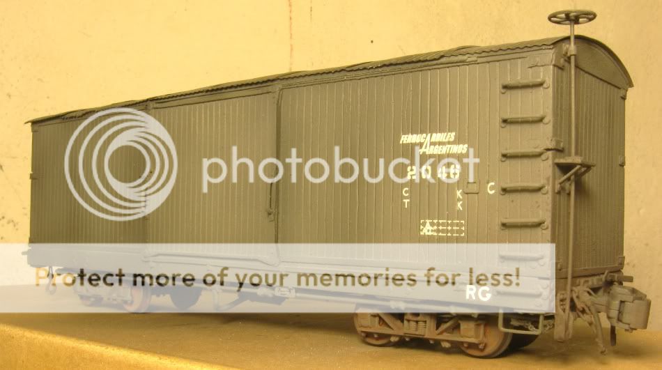

Since a long time!! I have no much time for the hobbie, but last week had a little extra time... so let´s show what I did...
This is a box car (called cubierto here), from La Trochita, the glorious Old Patagonian Express. I made it from styrene with many fittings from Grandt Line, couplers are from San Juan. Here´s a pic of the prototype, the model in procces and how it looks today, still needs lettering and light weathering.
Hope you like it!

      Nice looking model Lucas. I was curious on how you painted the trucks. Do you mask off the unpainted areas or scrape the paint off from the wheel/ flange? I am always looking for an easier way to paint them. Thanks  Sean

Sean: I painted the trucks and wheels separately, then when paint was dried, I mount again wheels on trucks and roll them over a rag dipped in thinner, easy way to remove paint from flanges.

I made a jig with 4 holes in it the size of the wheels and the thickness about 1" by 3" - 2 pc.
Place the wheels in the jig and rubber band the two plates.
Paint away!

Lettering is completed as seen on the prototype. Started in weathering too.

Now, I can say the "Cubierto" is finished in 99%, maybe some adds after your comments, why not? Weathering is done with Bragdon Powders mixed with MicroSet.
And some closeups from the underbody...

Nice model there Lucas. What couplers are you using?

Thanks Tom, couplers are San Juan 0n3 Evolution.

Looks good, but you are missing the wood stringers/beams that were used to hold down the currugated metal roofing at the outer ends. This was common/typical practice on corrugated roofs, and you look closely, you can see them in the prototype photo.
Sorry, the only image/example I could quickly find. Note the stringers/beams on the roof towards the car sides.

Yes Sir!!! you´re right!! How could I forgot this?? So, thanks for note that, will work on this next weekend.

The only comment I can make is the "rust" seems too monochromatic to me.
Some darker/other colors should be present.
And may be some wear on the grab irons (done with a graphite pencil)
