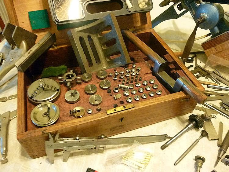

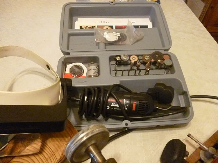

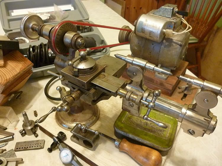

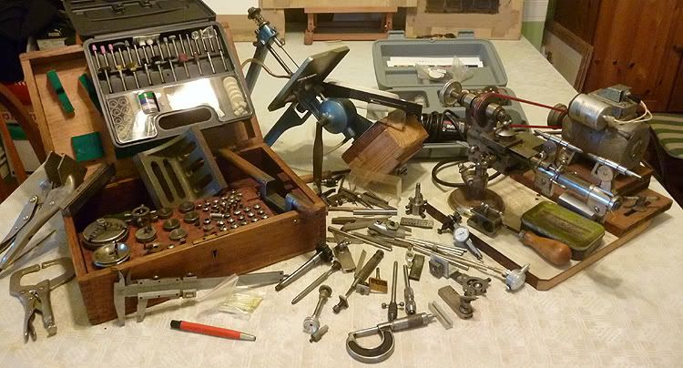

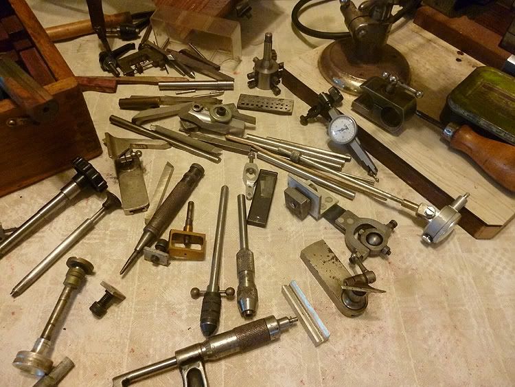

Well here's a quick post - and a few snatched pic's. Kind of looking for a bit of advice too, not the smart alecky kind, but some genuine honest advice.
You see - I've finally managed to purloin myself a Lathe, not a fancy all singing all dancing mega lathe but a rather old and a bit tatty "watchmakers" lathe. I love the size of it as it fits really well into my available space, doesn't have to go outside and will do most stuff I can imagine doing on it??
Done a bit of research online and it appears to be a "wartime or shortly thereafter" BTM "Geneva" style (don't actually know what that means) But it comes boxed with a fair assortment of accessories, most of which I don't understand or can't figure out how they work - it looks as though a few bits have gone walkabouts but most appears to be there?
There was a lot of other bits chucked in the box and .... well, you best have a look at the pic's and see what you think to my haul?
Here you go then .........
The "Haul".
The Box.
The basic Lathe on it's baseboard with motor.
Other assorted tools.
And a Dremel tool.
There is a great "mechanical coping saw" that I forgot to take a detailed pic of too - that looks pretty groovy.
Don't make me feel bad if this isn't the latest in tool fashion or it's not mega "the dogs dangleys" as I'm quite thrilled with my apparent recent good fortune - it pretty much is what I've been after for a long long time - and I don't think I was robbed either!
Would appreciate some positive opinions or advice on the usage of this kind of kit.
All the best ..........
Andi - Okay, a little slow to view this, but what you have there is some very expensive tooling especially if you were to 'try' and purchase individual items.
The lathe - used as per a standard lathe except collets are normally used rather than a chuck. For small scale brass and plastic I would definitely term that as "the bees knees".
I spent a few months sitting behind one similar during my intern time, the quickest and easiest way to get to know and learn is to just jump in - forget what all the books and taweb say, small scale machining is an art learned by doing. Those little machines can tolerate a fair bit of mistreatment (not recommended though  Cheesy).
I think you should post some shots of your 'achievements' on it  Wink
Incidentally there are about +$600.00NZD (300Pound) just in the measuring gauges in the first photo.

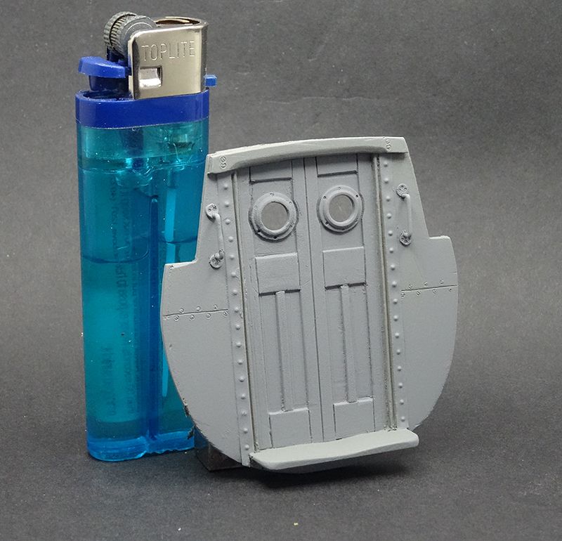

Here's a pic' though of something I'm trying to make at the minute, and the best can be said is that I turned the portholes out of styrene sheet - and learnt how to work with those "stepped collets" while I was at it.
In my own defence this is going to be a derelict so the lack of finesse is to be excused - which is just as well!!!

Styrene is actually very easy to machine cleanly, the trick to it is a slower RPM speed plus slow feed speed plus very sharp cutting tooling with a steep chip-breaker angle - a blunt cutting tool with a shallow chip-breaker is the cause for heat build-up = ugly parts. With sharp cutters you can increase the drive speed but still use a slow feed speed.
Ain't no shame in what you've produced there, at least you are spending time at the bench  Wink and enjoying the experience  Cool.
