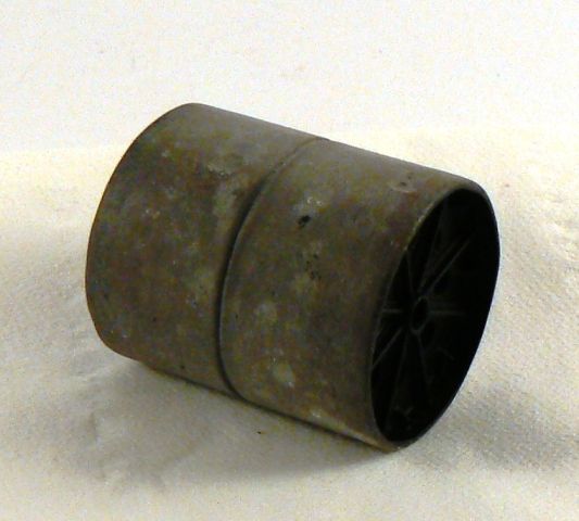

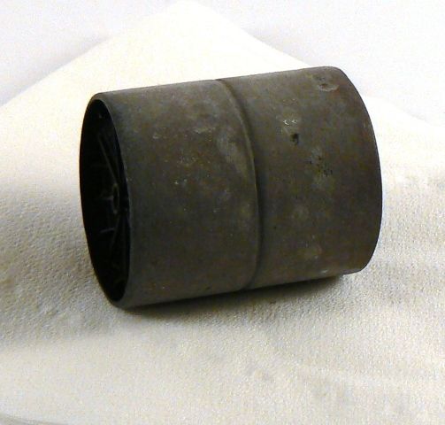

OK a critique from others would be of help to me.
Objective ;- to show surface finish on roller that is in use crushing a grey/industrial dirt base
Method :- surface initially sprayed flat black, then light grey sponged on and dragged around surface.
              medium rust colour then lightly sponged on, then when paint still damp MIG Industrial Dirt sponge on
              finally a few clumps of the pigment arranged on hard surface and roller rolled over them
Appreciate pictures are still not of highest quality (and I need to check under natural light in the morning)but I think its a reasonable start in representing the surface finish I am trying to achieve. But I have have been playing with this for last couple of hours and could be starting to believe my own propaganda .......... feel free to correct my delusions. Thanks
Posts: 1487
« Reply #16 on: January 21, 2010, 06:18:55 PM »
Looking back at the proto pics I have the following comments;
The splotches are not working for me, I did see "some" in the protos, not as many as you have
I think you need more "streaks" or the continuous lines from rolling / scraping.
I think it should be a little more (not much) umber, but the overall color is good (may be a tick lighter?)

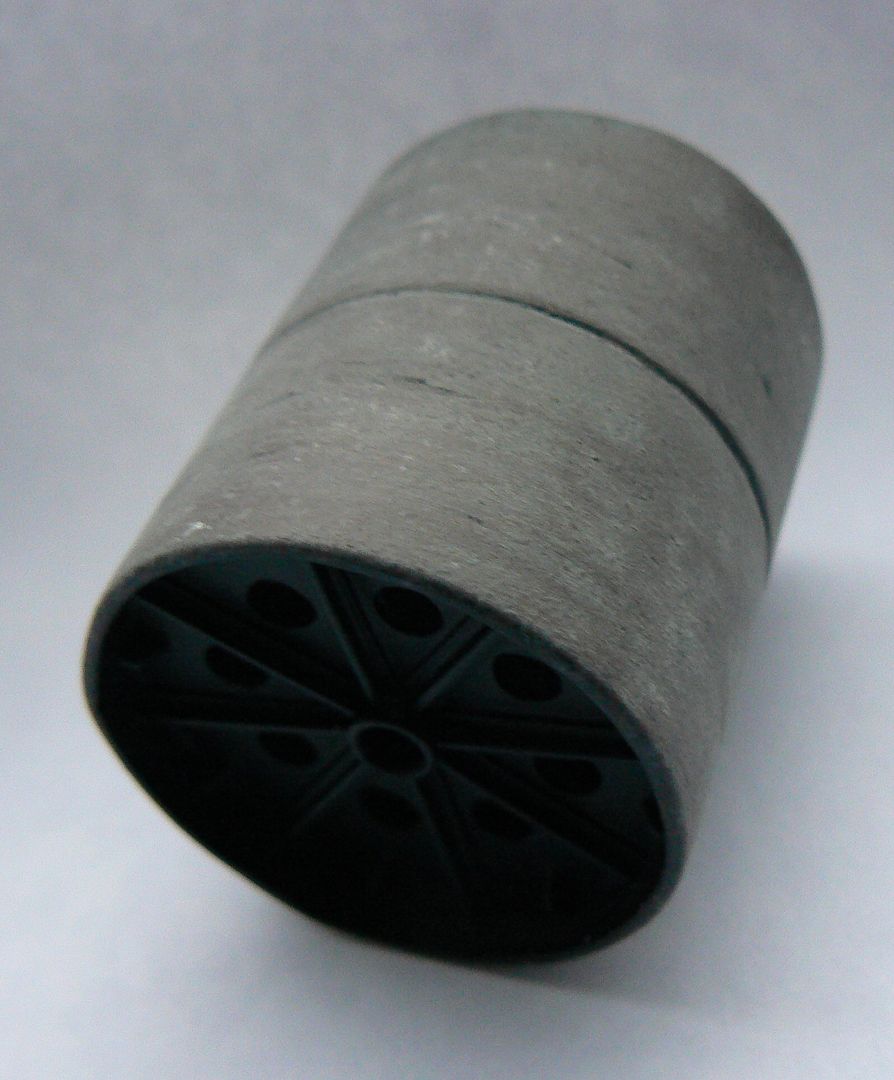

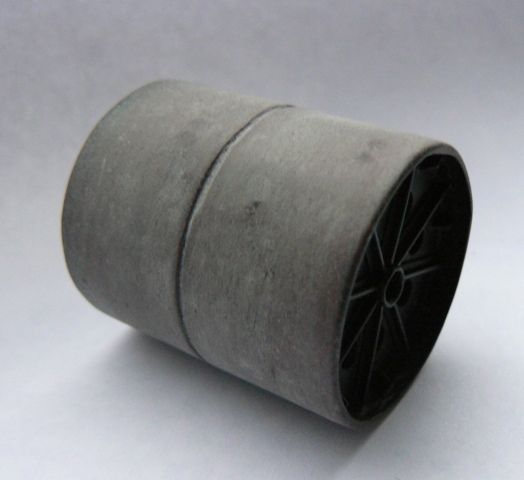

« Reply #17 on: January 22, 2010, 04:28:38 AM »
Marty,
A nights sleep and fresh eyes and I think your right.
Before I start again, I've tweaked current go ..... used a stiff brush and lightly brushed out pigments to try and lighten and "streak" finish slightly  and taken new photos in daylight!
                      before                                                                now
                      before                                                               now
I think its a bit better , lighter and real life it does look slightly streaky and its got that powdery look that I seem to remember on the surface of rollers .... I'm going to leave it now , concentrate on the crane and come back and then see what I think
Posts: 1487
« Reply #18 on: January 22, 2010, 06:53:46 AM »
MUCH BETTER!
I'm thinking a very diluted wash with oil - black, very thinned would be perfect.
please try it out before you ruin the roller due to me though Wink
Posts: 1080
« Reply #19 on: January 22, 2010, 10:46:08 AM »
   I second Marty, especially his remark om trying it out first........... Wink Grin Grin Grin Grin Grin
   The second photo's do look much better .........they show a well used roller surface and not one ready for the scrap heap.
