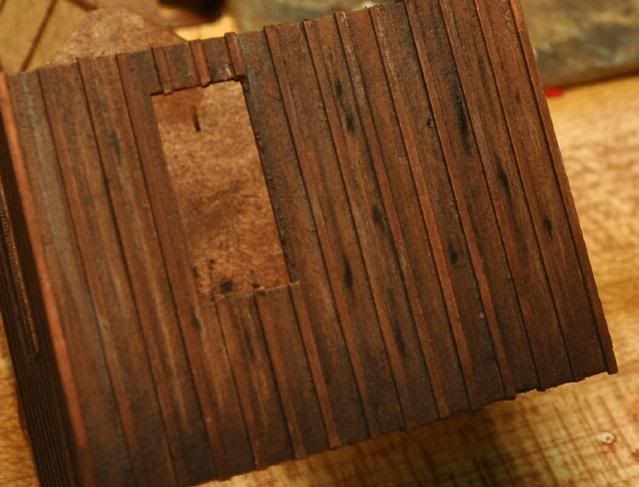

Came back to testing ideas, now that I have the Mig oils in hand.  This HO scale wall is 2" x 1.5" cardstock, paper battens glued on, wire brushed.  I painted thined out Mig Shadow brown over a mix of craft store acrylics. When dry, I painted a few knots.
Chester, your tip was right on the money, there needs to be some more variation in tones, to make a good simulated wood, thanks for pointing it out.  What I really like about using the paper and acrylic + oil washes, is the super color control I just cant get with stains on basswood and plywood.
I like the way that looks, I am wondering if the knots might be a bit dark.
The color balance is off and that could have a very strong effect on the relative lights, darks, and overall coloration. Dave, was your camera was expecting to shoot in daylight but, instead, the photo was under incandescent bulbs? Regardless, we can't draw any real conclusions about the knots until we have a more accurate image.
Reading "between the lines", I suspect the technique works and may need only a minor tweak to be spot on.
Russ, I don't know about the camera settings, new camera, haven't finished reading the manual yet.  For now, I just push the button and hope for the best.
One thing I forgot to mention-- and this is one of the big advantages of using paint-- the battens are glued on with thick CA glue.  I glued this test piece up in a rush without any consideration about glue ooze.   If this had been stained wood, or printed paper, it would have been completely ruined by glue smears around every batten.   But because the paint covers everything, I was able to sand off the more offensive blobs and ignore the smears, and assembled this thing quickly and stress-free.
The colors are based on a calendar photo over my workbench.  It shows a 100 year old barn in Vermont, the wood weathered to a reddish brown, and the knots stand out as nearly black.    I think it was periodically treated with linseed oil or some traditional wood preservative.

Actually, the laser knots look okay but stain around them might enhance their appearance. If this wall is just an experiment, try this, too: Lightly sand it to tone down the paint ridges left from the wire brush. The side lighting and macro image probably exaggerate them in the photo but, even so, a softer look might come closer still to wood. This ongoing attempt to perfect a technique is really interesting and should be of value when working with styrene, too. I hope a lot of others appreciate it. -- Russ
