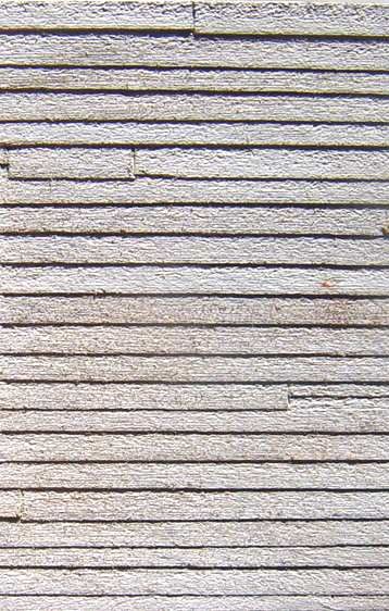

I tried a few ideas for HO scale paper clapboards over the weekend.  A scratch brush can add texture which suggests raised grain and/or chipping paint.  Scratch for texture, paint, then scratch again to chip away some paint. This is dark brown, then sand colored craft paint over laser engraved cardstock.
  I used this tool from MM.
http://www.micromark.com/Scratch-Brush,8058.html
I found it useless on wood and plastic because its too coarse.  There are wire wheels in a variety of sizes and gauges which should work just as well.

If you look closely at the above photo, you'll see the brush dislodged some paper fibers to create an almost fuzzy texture. That and what might also be the laser engraving, combine to yield what seems to my eye an overstated appearance. In some spots it almost looks like the grain has shifted from horizontal to vertical. Why am I sensitive to that? Because I've experimented in the same way and was unhappy with the results.
If you compare the paper boards in Dave's photo with those of a 1:1 structure the immediate difference is that the full size board texture is almost smooth, especially if you were to view it from 87.1 feet away. So if you brush the paper at all, it must be lightly, with only one or two passes in the same direction. I pretty much gave up on that technique because it was either too destructive or too subtle.
Art papers come in a variety of textures. Some look more like wood than others. If you choose a paper for its texture and lightly scribe it with a dull needle (a somewhat slow process since you must do each board by hand) you can achieve results virtually indistinguishable from wood with no raised fibers.
Alternatively you can simply leave the paper texture alone, or almost alone, and use paints and stains to get the results you want. A combination of both is what I decided comes closest to replicating reality. The accompanying photo isn't what I'd consider a superb result (it's only better than average) but I hope it illustrates differences in textures.
I'm really glad Dave took the initiative to experiment with paper. I look forward to his, and other, future attempts to push the envelope.

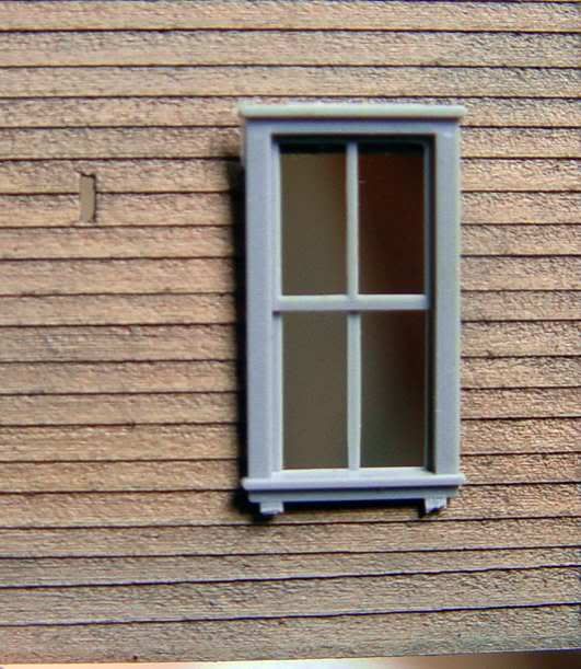

Fair enough, Russ.   Another experiment, slightly different method.  I washed brown oil over tan acrylic, scratched before and after.   Its meant to show weathered bare wood.    HO scale Tichy window.

Both excellent attempts. The first might be improved just by using a 600 grit sand paper to remove the fuzzies and smooth it out. Just a little too uniform too, different color chalks maybe?
 I like the second one better but again just a bit too uniform.

I think you should make your own windows! (Yeah, I already know you will. And they'll blow away Tichy's.).
The second attempt is better but still seems, to my eye, a little overstated even though it is HO scale. Maybe in that size you might want to give in to understatement: Try some un-textured boards and suggest the weathering with paints, stains, powders, or whatever. In HO, I've found you almost have to do that because the overall size is so small.

I think I disagree with Russ on this one ... that is an incredibly HUGE, gigantic, extreme close-up of Dave's siding and it still looks "good" (to my ignorant self) ... I suspect that in "normal" shots showing a full structure, or even some sort of "normal" close-up showing some small details along a structure, that this level of statement or overstatement of the desired detail will show well.
I think "understatement" of the grain detail, etc in HO means it would tend to disappear altogether ... and, to my eye, and keeping in mind the extreme close-up, I think you've got a degree of subtle overstatement that works well.  Of course, it would help if your photo were actually in focus!  Grin
PS -- Assessing these effects really draws heavily on personal preference, opinion, etc ... so just toss this in as my worthwhile or worthless opinion ... whatever!  Cool

Chester, I was studying some weathered clapboard while I was out walking the dog last night, and you are right about the color variations.  There are more contrasts in the actual wood.  A single plank can go from dark to light with a hard edge beween the shades.  I'll try to replicate that with the next trials.
On the exaggerated effect, again, agreed.  The back story to these experiments is they are R&D for a structure kit I currently have in design phase.   This time, I'm going to roll with some of the craftsman kit trends to see what happens with my bottom line.   Subtle doesn't sell.  In HO scale, subtle is invisible to the majority of customers.   Also the instructions must include painting instructions that are simple to follow.  No more than three steps to achieve the effect, and no exotic tools or paints.
So within those specifications, this is what I've come up with.  At normal viewing range, the effects are much less extreme and since the subject matter is appropriate for heavy weathering and dilapidation, the overall effect doesn't offend my sense of realism.  Still a way to go, but I'm happy with where its going.
