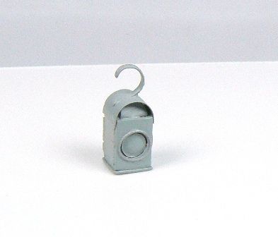

Went to use the work lamps I made here http://www.finescalerr.com/smf/index.php?topic=549.msg31899#msg31899
and realised they were not really very good, so had another go.
Different technique this time, 6mm hollow square tube, drilled out holes for lights/lenses, inserted inner tube and details made with brass shim. because the wall thickness of the tube was 30 thou inserted some 15 thou discs in hole to lessen the recess for the lenses outer rim is fuse wire rolled around drill bit and cut off and applied.
The final shots in primer do not actually have the lenses fitted, the domed effect is just the masking fluid I used ............. which may be an idea filed away for future

Excellent Gordon - much neater and carries the "Look" better.
I think your earlier attempt remains valid as an evolutionary stage in your modelling of this very successful piece so should in no way be thought the less of ............. a most constructive exercise.

WOW!
Those are little jewels!
Hope you made more than one!

Very very nice work.
They must be tiny.

I agree with Andi. Kudos.
