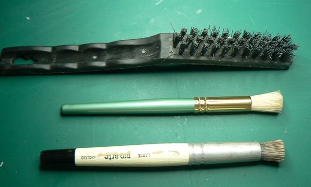

you are quiet right , there is shrinkage and even when dry the clay can be on the soft side. Think I have got away with it due the fact that any cracking due to shrinkage tends to follows the the impressed lines. I usually give the dried clay a coat of well thinned PVA glue which soaks into the clay which hardens it up and also reduces its tendency to absorb further moisture.
Marc,
Brushes
Top to bottom ......nylon bristle brush, comes as a set of three from the Pound shop, probably not too many of those in Pasadena, CA.
Next , hogs hairs brush
Bottom stiff stencil brush
Use the hogs hair one initially to clean out debris , nylon brush used in a gentle circular motion when clay is dry to round of edges. If really well worn cobbles needed then stencil brush is used.

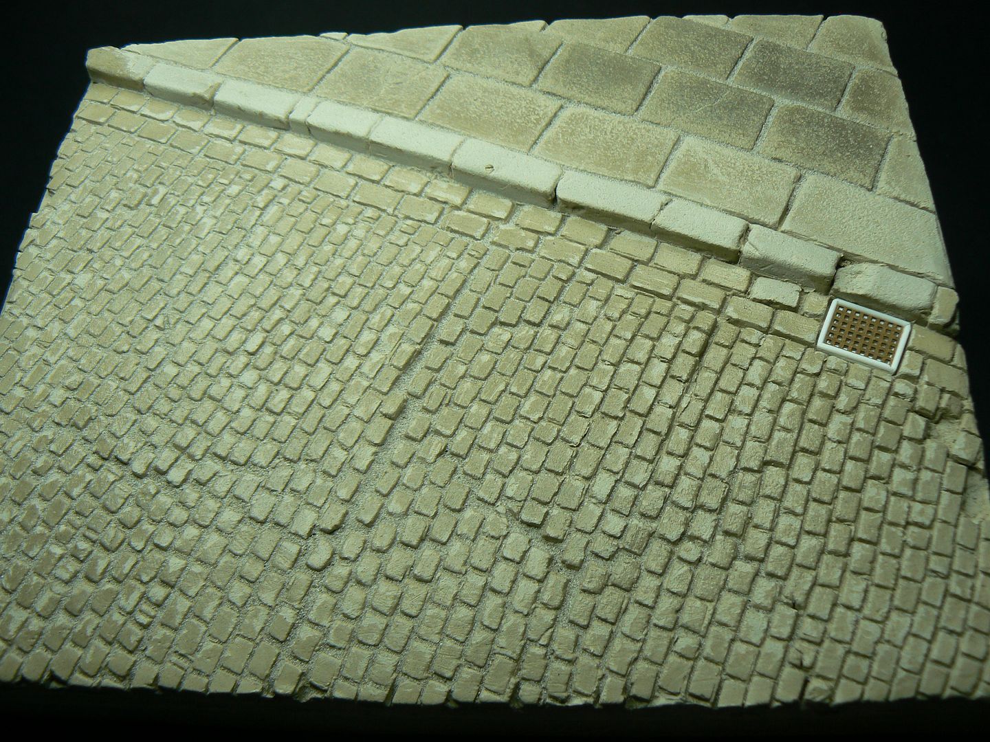

Having now found myself with a half done base thought I had better try and do something with it.
Added some kerb stones and pavement slabs, clay again, none of its painted yet and its still got loose sand as a temporary fill  ................. the drain was made with some of Vectorcut's new grating sheet (0.030" holes)

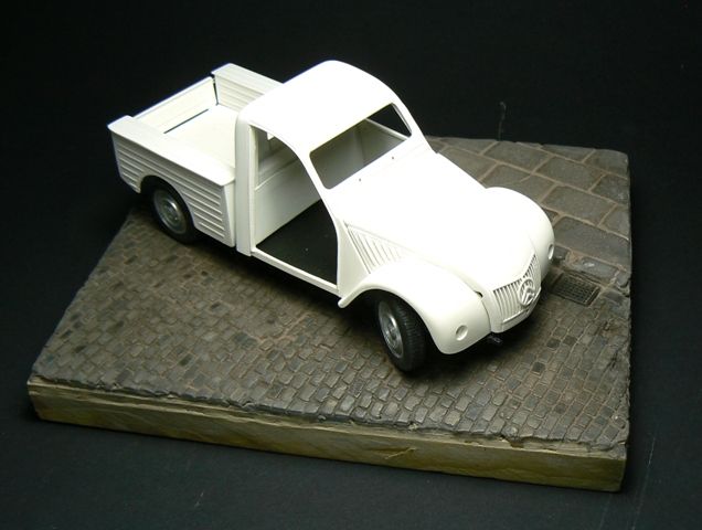

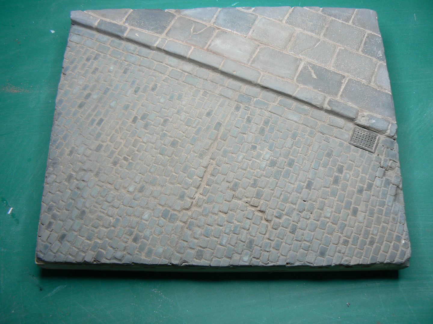

Just to bring this to a conclusion here is the base painted.
 I painted the clay with acrylics, sealed with a mist coat of Dullcote, joint lines filled in with DIY filler( tinted slightly for the slabs, coloured v very dark grey for the cobbles ) then dusted with MIG pigments.
Sorry for the colour difference in the photos, think the camera's on the way out?
Overall think the technique works reasonably well for the cobbles , but not for the pavement slabs .......... with these think a better way would be to score the joint lines after the clay is dry , doing it before the gaps get too wide due to the shrinkage factor
