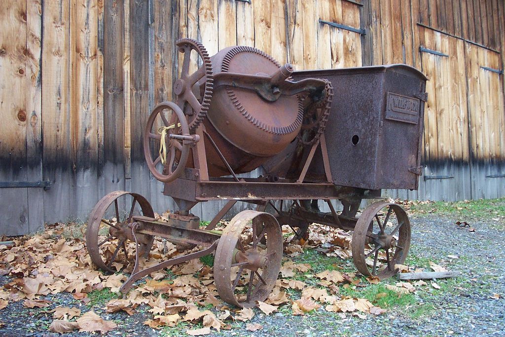

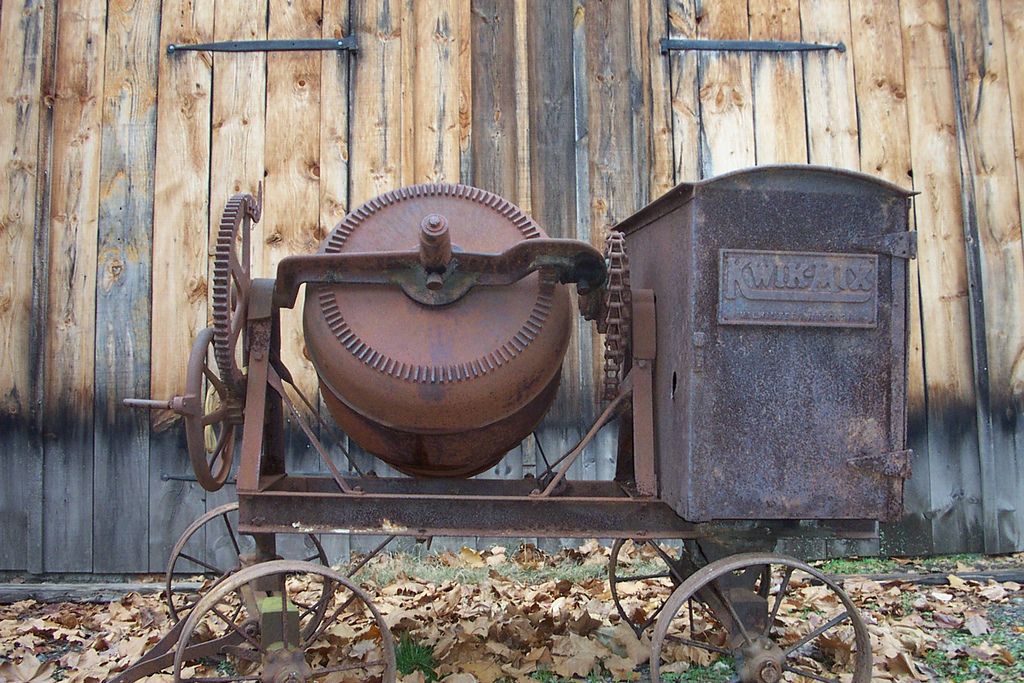

Early on in this thread Marc mentioned "cement mixers" and I posted a few photos of one I intended to model.
Whilst doing some more research on this subject came across these photos last week

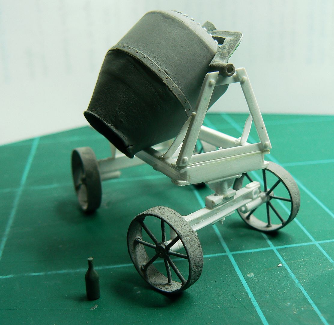

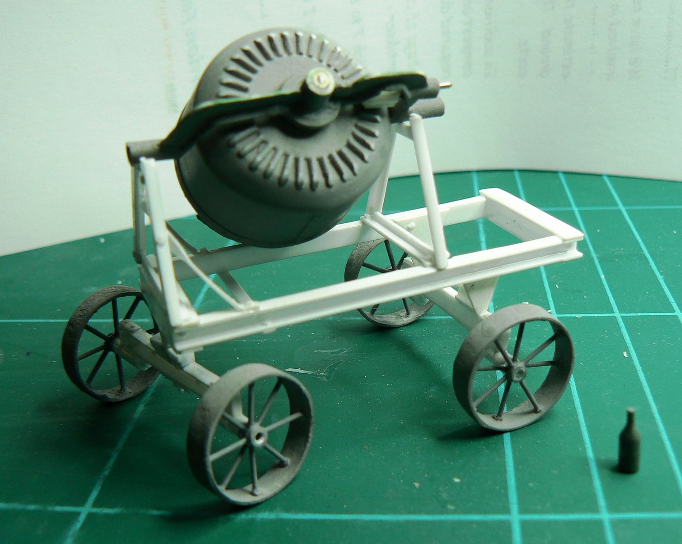

There was something about this one which really appealed, although I think the overall rust finish is beyond my painting abilities it is interesting to see how the different planes and different steel/iron have rusted in different ways and colours. Decided that I would have a go at in 1/24 to go with my road roller. Having no lathe could not go down the route Marc has started on with his, so went back to draftsman days and thought I would play around with producing the mixing drum out of paper. Produced a few trial pieces and then made the mistake of getting involved with Dallas on the subject of scale rulers. with a 1/35 rule in my hand I noticed that one of my trial pieces was exactly right for a 1/35 scale model so that is what I have ended up modelling ( as well as a 1/24 version!)
The beer bottle is the only 1/35 item I have to give some comparison shots, and the photos are quick & dirty ones at the bench.
Other than some Tamiya tanks I made years ago this is a new scale to me and I have struggled a bit to get things like the steel C frames to proportionally right, have scratched them from 20 thou strip but have thinned all the edges - would have been better starting with 10 thou but didn't have any in stock. The drum is made from paper and balsa, wheels from paper and rod, the rest from plastic strip.
Now that I am ending up with my only 1/35 scale model going to have to find a use for it, thinking of it abandoned at the the side of a building (maybe a Nissan Hut) bit of grass, bit more junk etc.

That is one sweet little model. A great scene addition. Looks like I may have to copy it. Thanks for posting this.
FWIW, I didn't build my drum on a lathe, (the lathe and me don't get along) I cut up the mixers from some matchbox type cement trucks. Grin
Posts: 3066
« Reply #374 on: March 31, 2011, 02:13:34 AM »
I really like it. -- Russ
