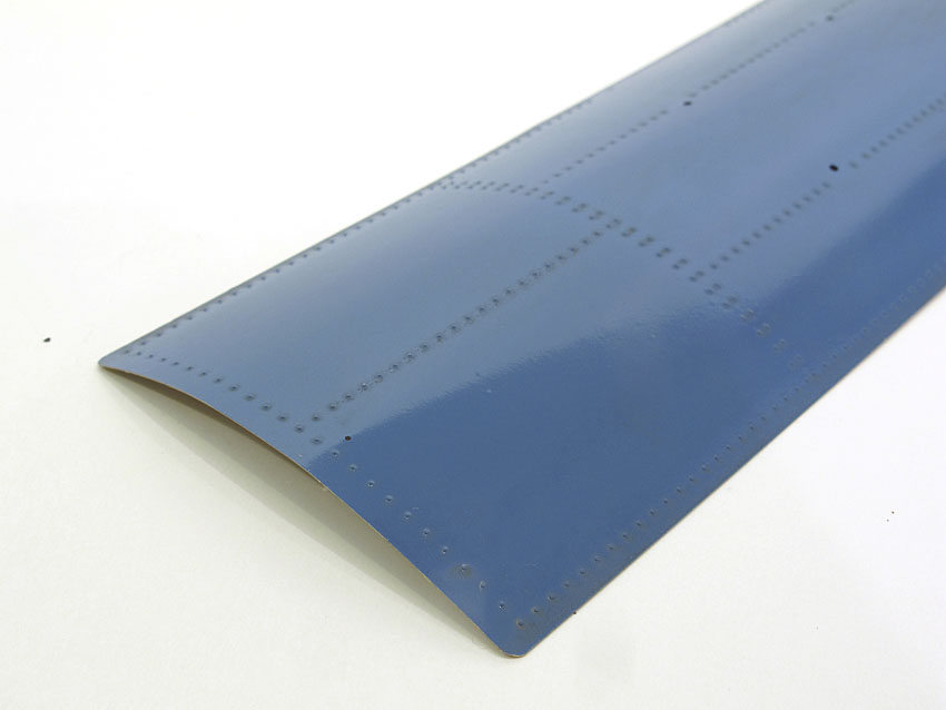

Painting is definitively the last big hurdle in this project.
Truth is, I have already painted the model a couple of times, but unhappy with the results it was all washed off with laquer thinners. Thats the beauty of metal models, no risk of  dissolving the model!
Airbrushing is a very tricky issue in my book. I never get close enough to that "sweet spot" where the paint is going on really wet, very, very close to running.
Doing test pieces, I relax a bit more, and here is a piece where I almost nailed it:
Paint is Tamiya gloss acrylic paint thinned 1 part paint to 2 parts laquer thinner.  The roof has been given an dark brown oil paint & turpentine wash.
A bit more practicing, and I am ready to tackle the real thing!
Can acrylic paint be thinned with lacquer thinner?

Tamiya acrylics works very well with laquer thinners. But this seems to be quite a controversial truth, I have seen some rather heated discussions online regarding this. I have never heard that you can thin any other brand of acrylics  with laquer thinners.
I first heard about using laquer thinners with Tamiya in Adam Wilders video on modulation.

It works, because Tamiya acrylics are not "true acrylics" as we think of them, in the sense of being water soluble paints like other/typical acrylics (you can't/shouldn't thin them with wate). Tamiya lacquer thinner actually is perfect for spraying them, because it is a bit less agressive than regular LT. I have though been able to get equally good results with their standard X-20A thinner. IMO, it dries a bit slower than than the LT.
I think you got a nice result with the gloss....I have actually found them to be a bit challenging to spray, compared to the matte finish.

Nice work Hauk! To avoid runs and other problems with the Tamiya X-paints I just use the XF-paints and finish with one or two coats of X-22 Clear and you have the same result as with the gloss paints and also all your ordinary range of colors to choose from.

I fear that you have a very good point... I also wonder if a semi-gloss finish would work. So maybe XF with some glaze added could work.
