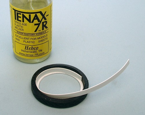

To make the actual rim, I placed the ring and tire flat on the workbench and glued a piece of
.020" strip stock around the edge, against the inner edge of the tire, like this.....
There probably should've been another photo or two before this one, but I got involved
with the building process and didn't stop to take pictures.  I added another strip-stock ring
for the spokes to sit on and made a circle template on which the outer rim and hub (from the
same '48 Chevy the motor came from) are attached with 2-sided tape, then measured, cut &
glued on the styrene spokes.
