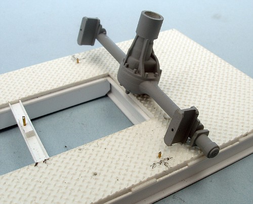

My newer, freelance piece is powered by a Chevy six:
The platform is diamond plate "welded" to channel stock.  I'm using the radiator & axle
from the same '48 Chevy the motor came out of to enhance the story of a home-built lumber
buggy that was made from parts found around the yard.
The seat was found in the parts box.  I think it was from an old sprint car kit and had to be
narrowed by about 3 scale inches.  I didn't notice the rear axle cradle wasn't pushed down
onto the pin for the photo....
Speaking of pins, one thing I learned during my "Model Car Years" was using pins to locate
sub-assemblies. The transmission, axle unit and seat are all positioned with pins, which make
mocking up the model really easy and assists no-end in final assembly.
