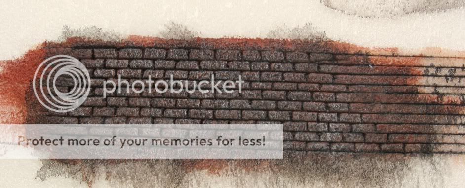

   The wall is looking better all the time and I like the blockwork infil .You have got a good texture for the blocks. I am thinking of doing some myself so your experiment is going to be very useful .
   There are two things that would improve it for me when the time comes to do it for real, firstly some more lighter reds incorporated in the brick colours and secondly less mortar on the bricks themselves as to me that suggests either sloppy workmanship on the bricky's part or the remains of a previous coat of render(stucco).

Thanks Nick,
I agree, am still working out the kinks on the grout...part of it is due to the spackle collecting in some of the open pores. I also really want to play with the random coloring...however it is interesting, that there really is no one set type or coloring for brick walls.....I spent hours on sites collecting brick wall pics, and there is absolutely no consistency....at times not even within the same structure. Even here in town....every structure even when right next to eachother is different.  Roll Eyes
For some reason the spackle does not take "post application" coloring/staining well.....works best when pre-tinted. I might give the lightweight spackle a try to see if it works/reacts differently.
I am also interested in seeing how this technique will work with the "Precision Board" that was recommended to me. Apparently it's a much denser closed cell material...and it is meant for hand carving or machining....so the grouting may come out cleaner/crisper for newer, more intact walls. Waiting for samplpes. Will post an experiment when it arrives.
