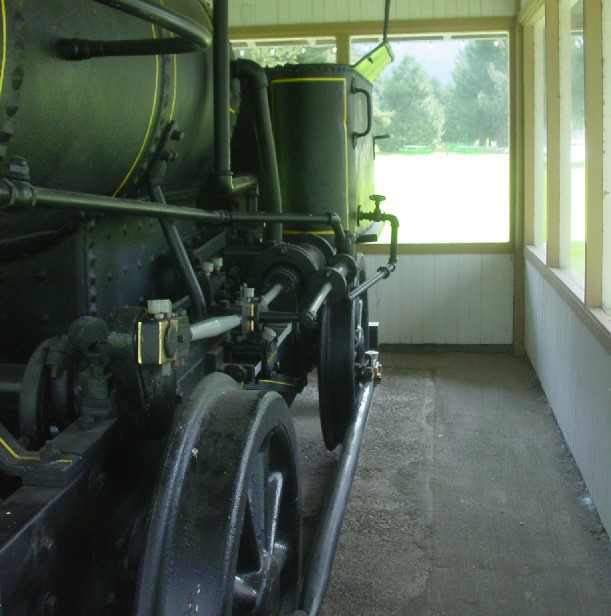

Marc, is that better. I like the injector or is it just a Water pump.I am looking for more detail on the back head,valve gear,and ash pan.

« Reply #7 on: May 24, 2009, 05:01:54 AM »
Quote
It appears to be a drive cylinder with a water pump mounted on the side. What's really strange is the linkage to the drive shaft. In the photo it's hard to see how the shaft would clear the wheel and frame when the crank is at the bottom of the revolution.

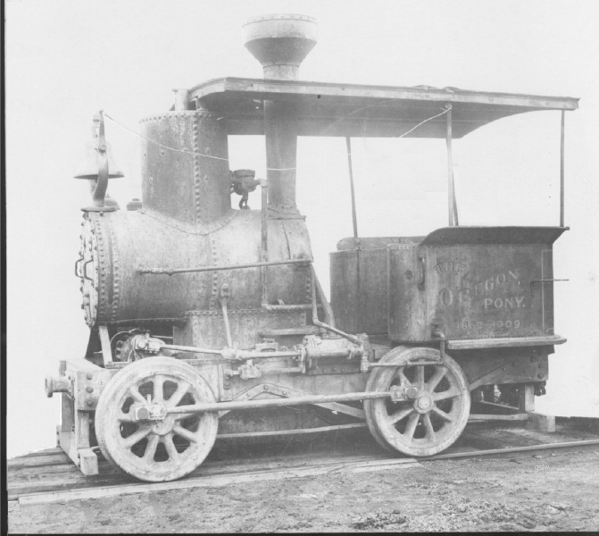

« Reply #11 on: May 24, 2009, 11:14:31 PM »
Here is one of the better photos I have.  You can see how much room there is between the wheel and frame.  The prototype is 5 foot gauge and my model is standard gauge so I have less room. So I have to do a little give and take. The valve gear is inside of the frame.

« Reply #12 on: May 25, 2009, 05:29:00 AM »
Quote
That makes things a lot clearer. I guess you're dependent on other peoples' photographs for this. One thing that's handy if you do get to worship at the real thing in a case like this is a rubber lens hood you can press it against the glass to kill the reflections, but still move the camera around a bit to frame your shots.

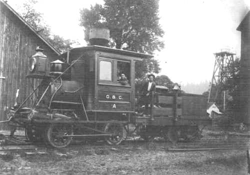

« Reply #13 on: May 25, 2009, 08:07:02 PM »
Old Betsey, this is another little engine also built in 1862 by Vulcan Iron works of San Francisco, California. Plans are in the March/April 1990 Gazette.

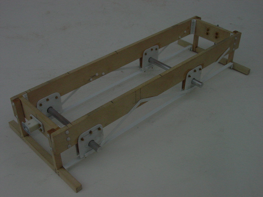

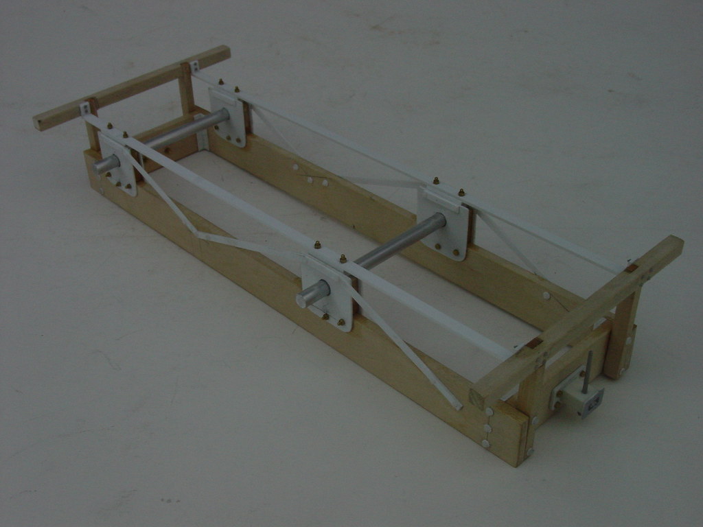

« Reply #14 on: May 25, 2009, 08:48:00 PM »
