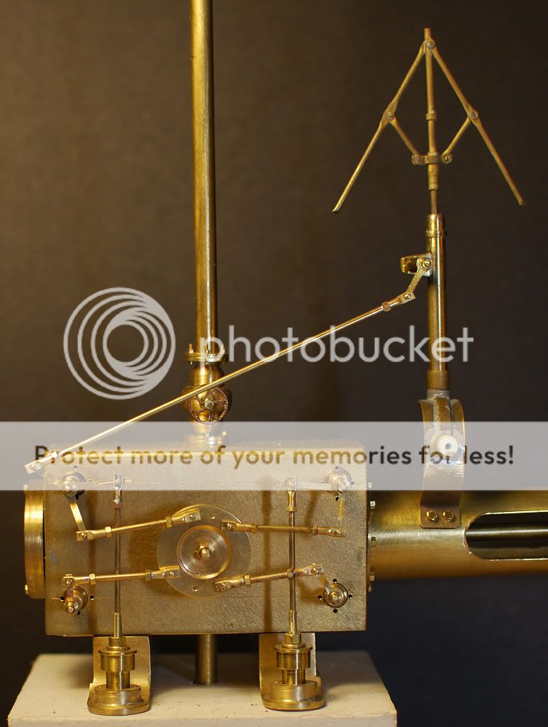

The valve gear is complete....sort of.
I need to get some acorn nuts in 00-90, 1mm and do some final shaping of the clevis'.
Close up.
The clevis and links were a lot of fun (not) several machining steps and fabrication of jigs to get the holes correct. The clevis start out as .062" tube and the rods are.045" for size reference.
And yes the linkage is all functional. ;D ;D ;D ;D

Hi Marty, just catching up, beautiful workmanship on the engine.
Whoa.... this just gets better and better. Love all that spaghetti linkage Marty. It has a certain Rube Goldberg character to it. Superb work as usual...
Marty, when are you going to make some progress on the Corliss? As for the photos, I hope you did that without any help from your mom. -- Russ
P.S.: Don't paint this thing; it's too gorgeous to cover up.
Please hook it up to compressed air! I want to see the "whirl-e-gig" spin around! ;D ;D
Gil
Very nice Marty, looking forward to the diorama.
