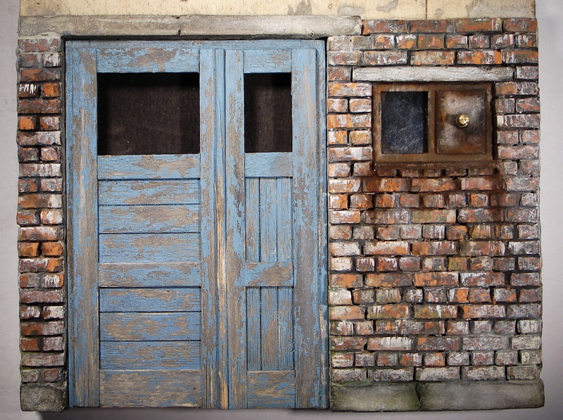

That's some very nice modeling, Marcel. The brickwork and the weathered door are both quite convincing.
What did you use to make your bricks?

Very nice.  Just great coloring in the brick but the door is just outstanding!!

Interseting build, like the others I am impressed.
How about a little more info on what you did and how you did it?
Especially on the mortar, I just screwed up a beautiful chimney by adding the mortar.....

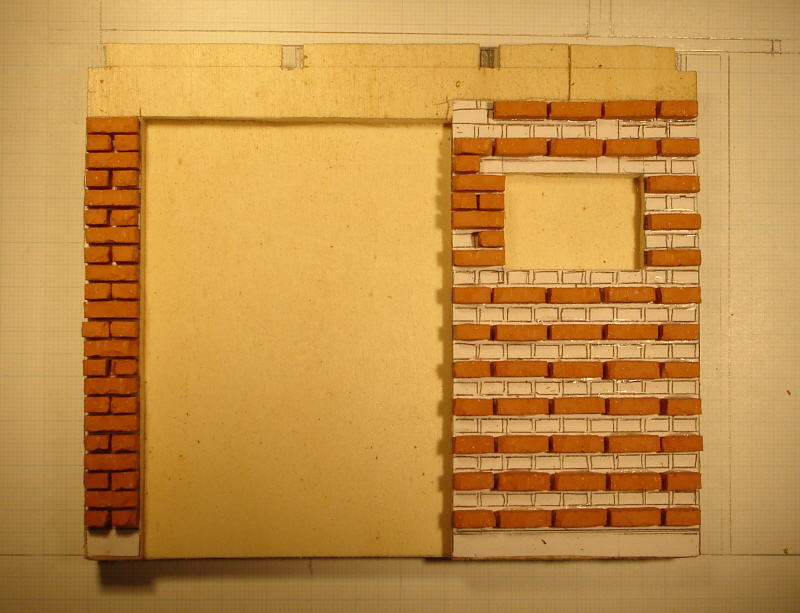

The building is to be  small storage shed for fertilizer and pesticides to go with the Feldbahn (Field/Agricultural Railway) Diorama
Pic. 1:
An initial mock-up was done with foam-core to check size and proportion.

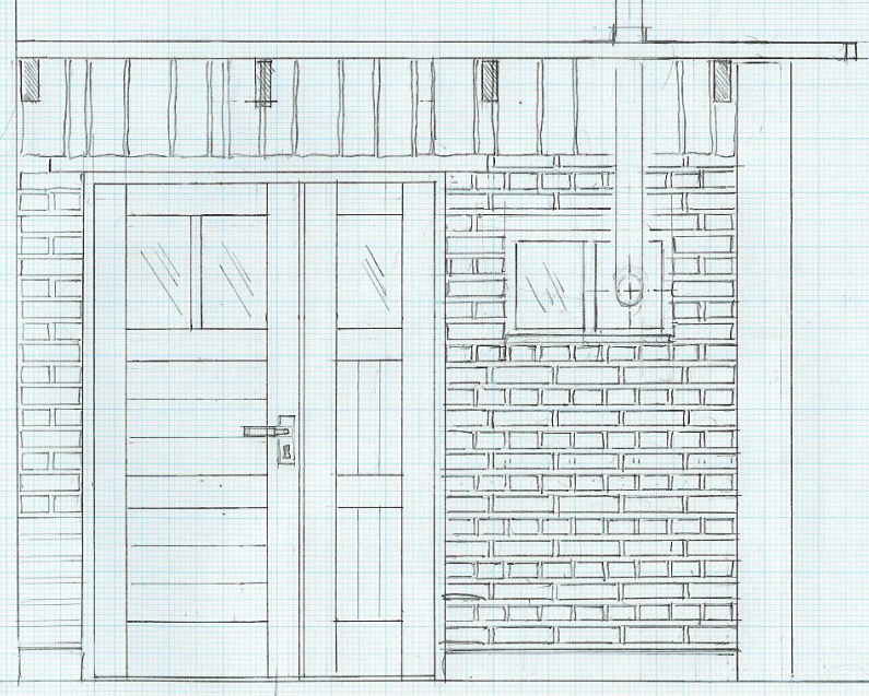

Pic. 2:
A drawing was then done of the elevations based on the foam core model.
Pic. 3:
A sheet of thin plywood was cut as backing sheet, onto which the brick portion of the drawing was glued, so it would serve as a layout/gluing template.
Pic. 4:
165 Bricks later…..this is the result. The bricks are from http://www.miniaturziegel.de
Pic. 5:

Pic. 10-14:
These photos illustrate my process for building the door. All the pieces are individually cut from 1mm thick Basswood.
I employed the following steps to achieve the wood finish and chipped paint effect.
1. Brush the wood pieces with Oak stain (water soluble).
2. Apply a grey tone/finish with white and black water colors
3. Seal everything with Flat finish
4. Thinly paint the entire surface/door with a liquid masking Film ( I use Gum Arabic [pic. below], which is available in art supply stores…but other products are available also).
5. Then Brush apply the acrylic paint/color (In my case I used a mix of Ultramarine Blue, Smaragd Green, and Titanium White).
6. Then, using masking tape I carefully begin to remove the paint. This is done in areas at a time, to achieve the desired effect. Some areas may require repeated dabbing, or more pressure, of the tape, in order to get remove the desired amount of paint.
7. Add any additional weathering, staining, streaking as required/preferred.
I prefer to paint the whole door in the Gum Arabic as this way I have the flexibility of removing paint anywhere I feel it needs to once I see the painted door…rather than trying to decide before painting where I want chips, and only applying the GA there….allows me to be more intuitive and flexible with the effect.
To do this door, I probably dabbed it about 100 times to get the amount of peeling….it took about ½ an hour.

Pic. 17:
Another picture of the door with better lighting.
