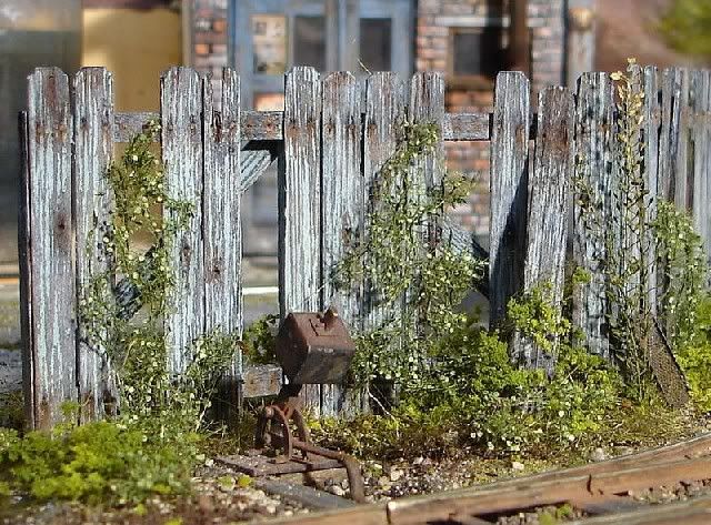

« Reply #10 on: October 26, 2009, 12:59:36 AM »
Harald,
You are correct...I was mistaken...I was sure he used the masking solution, but I found his fence thread on Modellboard.de, and he notes he used Gum Arabic.
A photo of Marcels fence for those interested:
« Reply #11 on: October 26, 2009, 01:18:45 AM »
