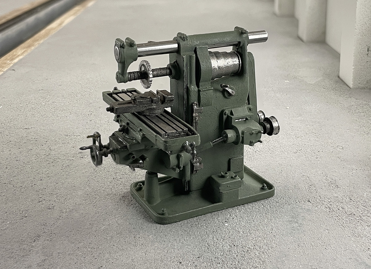

I thought that my new iPhone 12 could replace my need for a proper camera but I  am starting to realise that this unfortunately aint so.
First, the fixed aperture gives a pathetic depth of field that make focus stacking an absolute necessity
This image of my dear universal miller requiered 20 exposures to get a depth of field going from the front handwheel to the back of the machine.
And stitching the images in Photoshop leaves a lot to be desired also.
The closest focus distance is a 2-3 inches, wich is not very impressing.

I have no specific camera to suggest; only that you may have to use a 35mm SLR or mirrorless camera with a macro lens to get the results you want. Those cameras have higher resolution than iPhones and digicams so it may be possible to shoot from farther away, crop the image, and end up with a much better photo overall.

At least the iPhone 13 has a macro function, so I think I would be happier with a 13.
But the problem with the fixed aperture is harder to get around. I would have loved an in-camera focus stacking function.

I have been very happy using a used Lumix FZ1000 (about $450 new, $200+ used) with a Raynox Macroscope snap on lens model M-150 (about $70)
The Lumix has a tilting LCD screen which is nice while mounted on a tripod as you can tilt it up to see the image. It also has focus highlighting as you adjust the manual focus. I set it up on the tripod at the position I want and then do a series of shots from close to distance. The in screen highlighting makes it really easy to see what I am focused on. I then load all the images in Photo Shop and do focus stacking. The Raynox lens takes the place of a macro at a very reasonable price and with excellent image quality.. it snaps on and fits lens diameters from 52-67mm.
