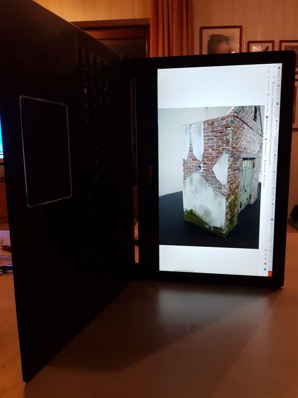

« Reply #25 on: August 19, 2019, 04:32:28 AM »
Side wall now added, the model will be in "low relief" as a backdrop to derelict locos, wagons, etc.  The broken rendered parts are made from plaster (as per Marcel Ackle's tutorial on his website)   It is cast onto 10thou plasticard with a depth of just 0.5 mm (it makes it VERY fragile), when dry removed by turning the casting upside down and peeling back the thin plasticard.  The broken up parts are then PVA glued onto the brick wall and weathered with water-based paints and powders. The hole in the middle will be for a steam pipe from a boiler (rusty of course!) outside the wall.  I tried "cracking" the plaster but it turned out to be too well glued on.
Les
Les Tindall
Posts: 244
« Reply #26 on: August 19, 2019, 04:37:09 AM »
sorry the phot is sideways, you will all suffer neck ache trying to look at it!
Les
Posts: 5722
« Reply #27 on: August 19, 2019, 01:00:10 PM »
Upright or sideways it shows the very adequate quality of your work. -- Russ
« Reply #28 on: August 19, 2019, 02:21:31 PM »
looking good - but my neck aches -
Online Online
Posts: 784
Klosterstollen
« Reply #29 on: August 19, 2019, 02:44:20 PM »
No problem you just have to put the PC or the monitor right.
