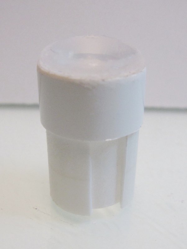

Anyway, I've mostly been working on adding all the details to the supercharger. The air filter was made from a short segment of 5/8" styrene tube, with a piece of 1/2" tube stuck into it. An acrylic, elliptical dome was used to make the rounded bottom of the air filter (shown bottom up in this photo):
I cut another segment of 1/2" tube and cut a slit in it, so I could wrap it around the first tube. Later I cut a piece to fill the gap:

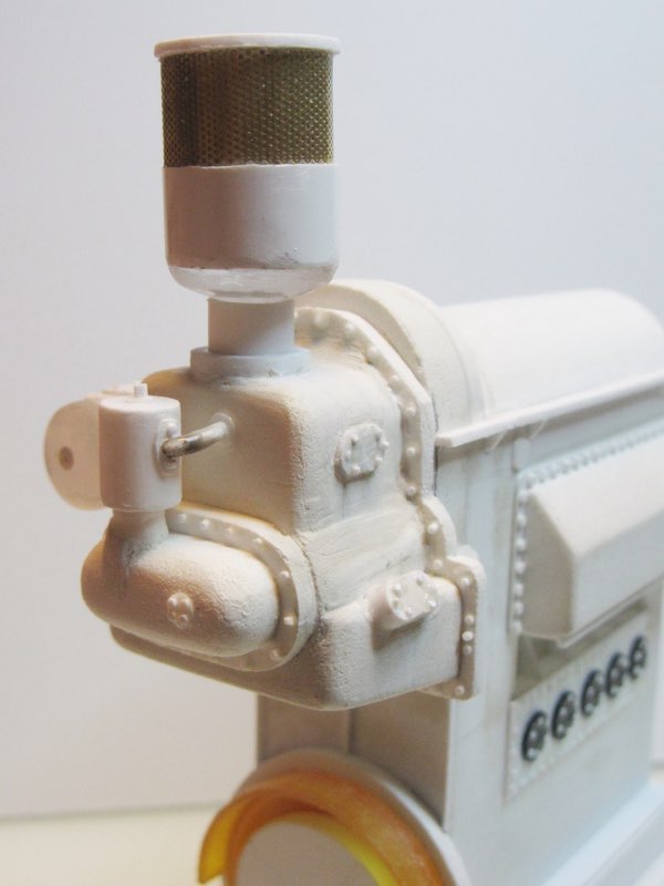

Here's how it looks on the supercharger. I haven't glued it in place yet, it's just sitting there. The other details were made from various bits of styrene tubes and strips:

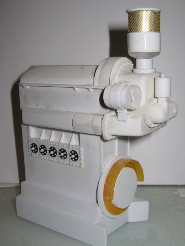

Here's the whole engine so far. The orange piece was made from the bottom of a prescription pill bottle:

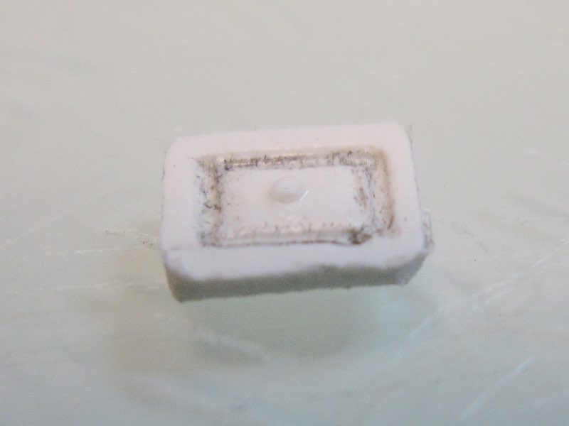

A few days ago I posted this photo of a styrene test piece for the covers on the engine:
My plan was to make a rubber mold and cast these things in resin. But that test piece was too rough. Well, I tried a couple more and couldn't get it to look as good as I wanted. So I tried a different approach, making it out of 1mm Sintra and scribing the indentations. That turned out even worse:
Even if I could have created a suitable master, I had doubts about how well such thin pieces would reproduce as castings. So I scrapped the whole idea and decided to come up with a non-prototypical design that would be simple enough that I could make all 20 of them individually. My first test of this was extremely simple, just a flat piece of styrene with rounded corners and a nut/washer in the middle:

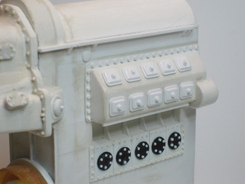

But I felt that this was TOO simple. I wanted something that looked a bit more interesting. The design I settled on was made by layering two pieces of .020" styrene. Both pieces had the corners rounded, and I beveled the edges of the smaller piece before gluing it on top of the base piece. Here's how they turned out:

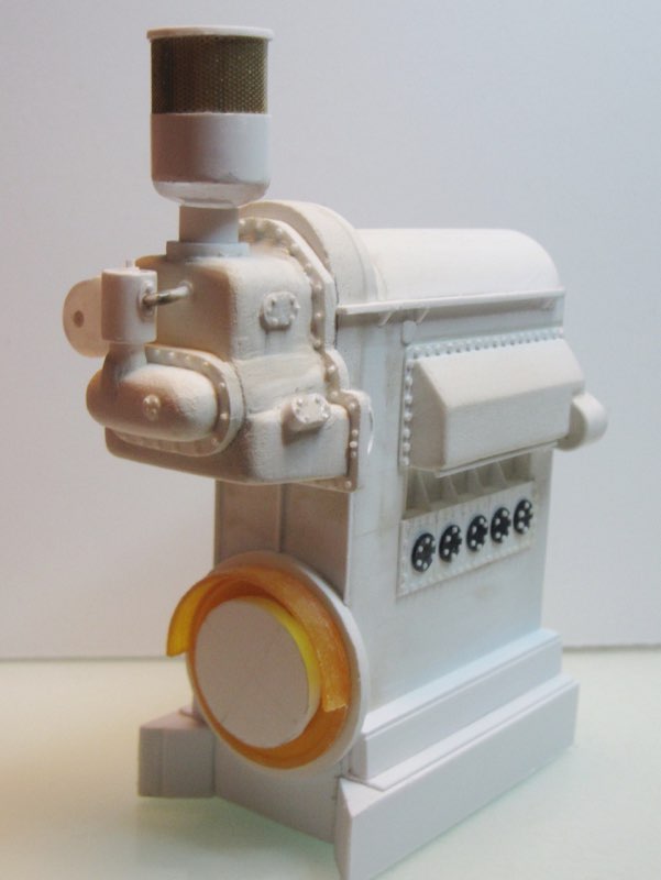

I also did some work on the base for the engine and generator:
