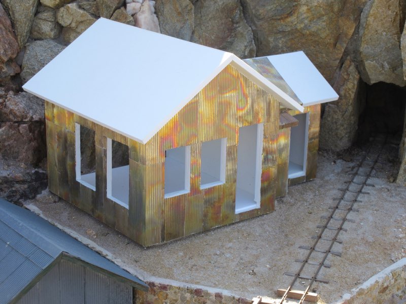

Next I started on the corrugated metal exterior. I had previously used real, galvanized, corrugated steel from Rainbow Ridge on my Assay Office building, and considered using it again on this one. But this building has more windows and also many more angles and joins, and the steel is difficult to cut or bend. So I went back to making my own corrugated metal out of .001" thick shim brass sheet. This comes in a 6" wide roll, and I cut into 4" x 6" sheets. I heat the sheets of brass with a plumber's torch to anneal them. Then I place each sheet between two pieces of the corrugated steel, and scribe the groove using a dull pencil:
I start at one end, and scribe a short section at a time until I've gone more the half the length of the piece. Then I turn it around and start scribing the other end, and meet in the middle. Next I flip it over and scribe the other side. When it's done, I trim off that piece (about 1" wide), remove it, place the remaining brass in between the steel, and start over on the next piece. Tedious, but eventually I get it all done. The pieces of corrugated brass are then sprayed with oven cleaner to wash any residue off. After rinsing with water they are set out to dry.
I glue the corrugated metal to the structure using Dynaflex 230 paintable sealant. At this time I have completed covering the exterior walls and have just started on the roof:
There is no need to apply metal to the rear walls, since they will be up against the cliff and not visible. In this photo the rear walls have been removed:
Here are a couple shots showing how it will look on the layout:

I finally finished creating and installing the corrugated metal. Here's how it looks with all the metal in place:
This overhead shot shows how closely the building fits against the cliff:
Soon I can begin painting it. But first I have to do some work on the doors and windows.
