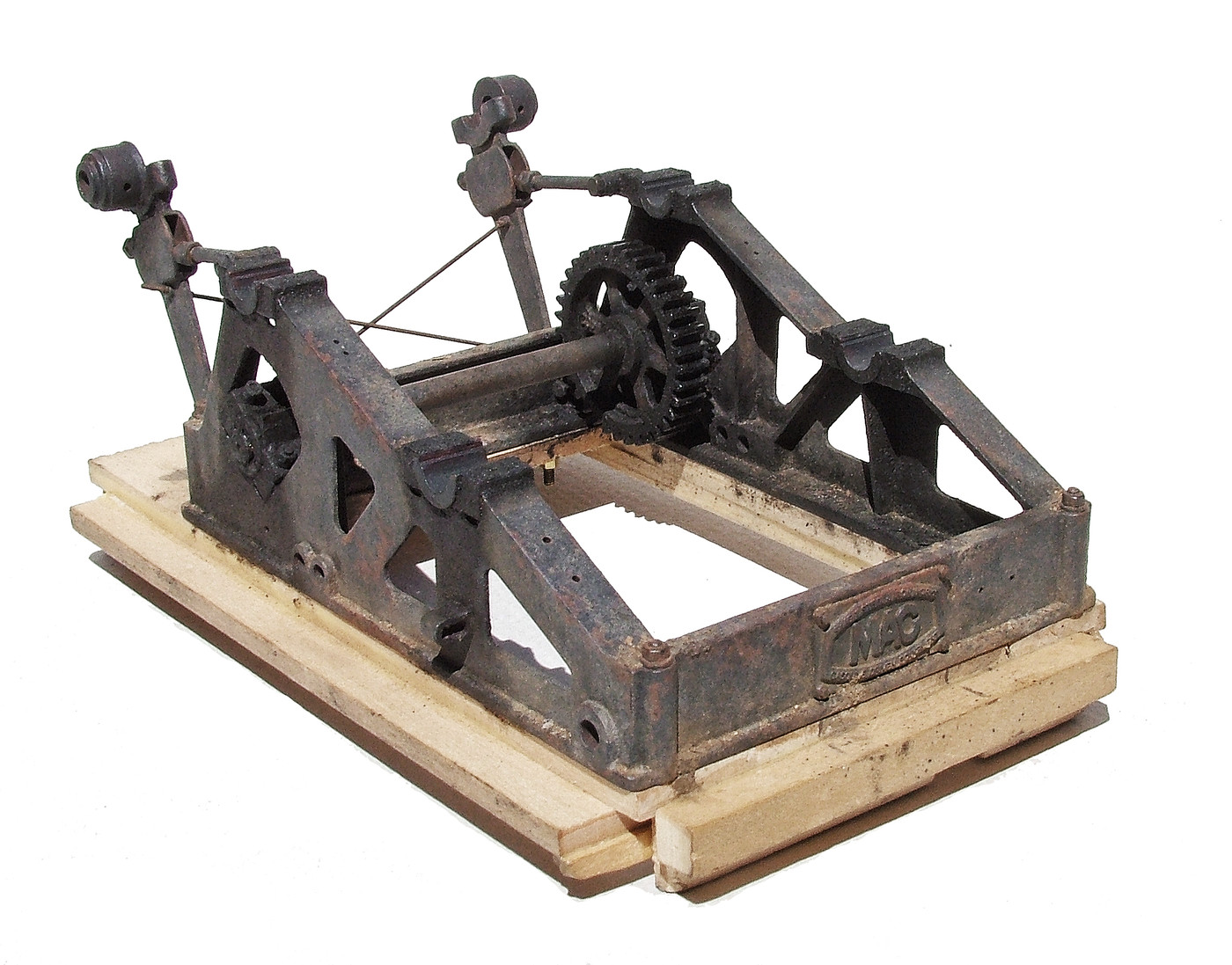

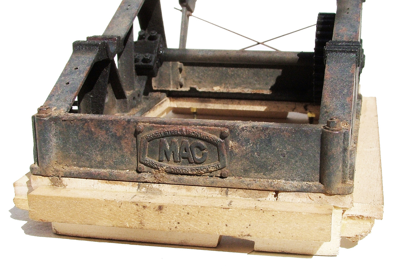

Thanks Franck!
Finished the builder’s plate and mounted it. McLeod model RR nuts finished it off. These were made of cast steel, but I don't know if the letters were polished or not. So, I just painted it.

Looks fantastic Chuck!  The little details like the builder's plate really make a huge difference in the overall effect.

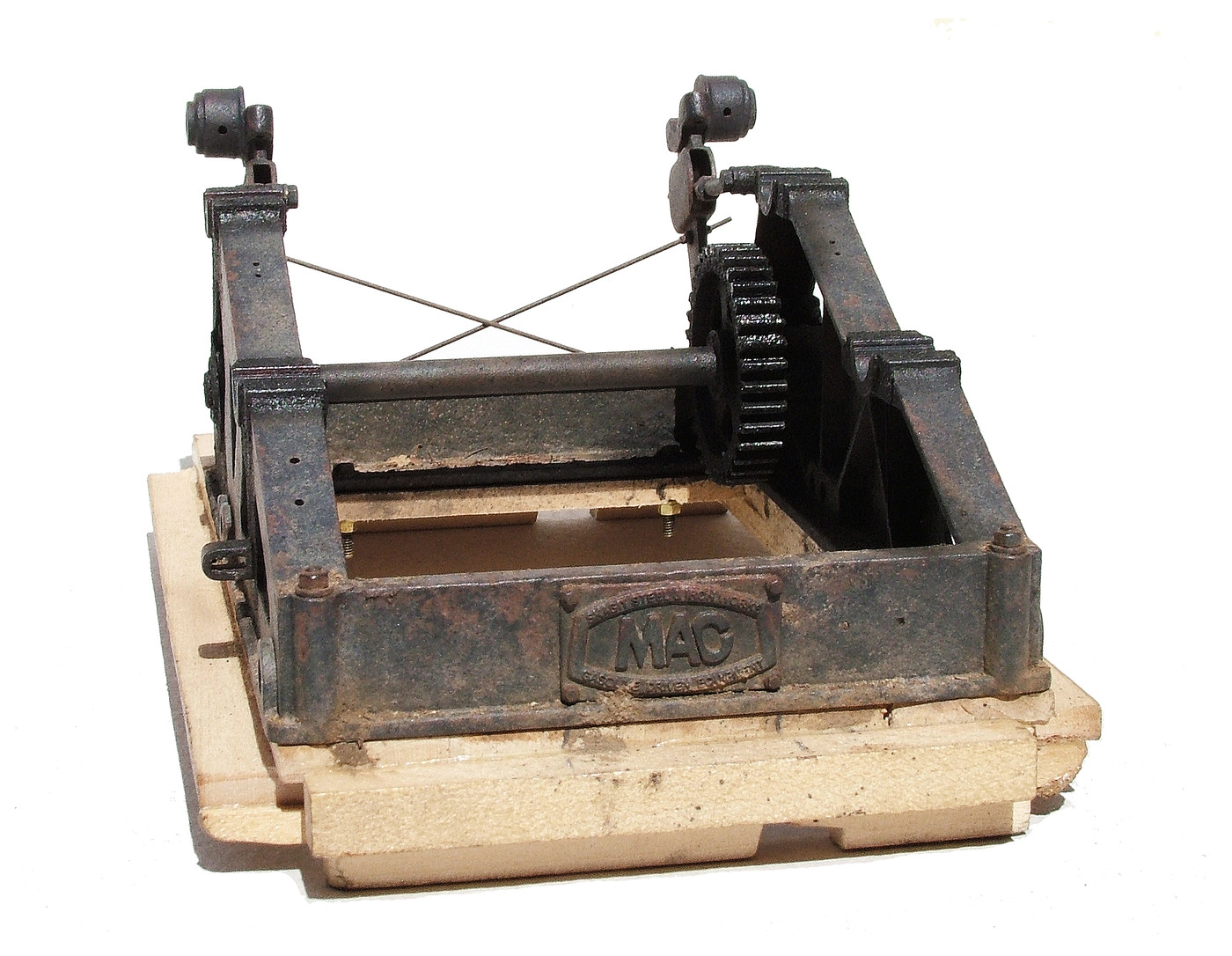

I made some more progress this weekend. Dry fitting the haulback (trip) drum (pardon the drill bit). The 3/8” diameter (.024 actual) wire rope is 7 x 19 strand stainless from Mcmaster-Carr (the more strands, the more flexible it is). I wrapped 25 tedious feet around the core using super glue to hold it (excess easily removed with acetone). Hardest part was keeping it from kinking and away from the cat. The core is separate from the ends to facilitate handling and do-overs (already needed). I used a heavy wash of black oil paint to simulate well kept and oiled rope. Will make a nice contrast to the war weary look of everything else. The end fitting (closed spelter) was also 3D printed and buffed with Rub N Buff and oil warshed.
Much more to do, thankfully. I haven’t enjoyed a model like this for a long time.
