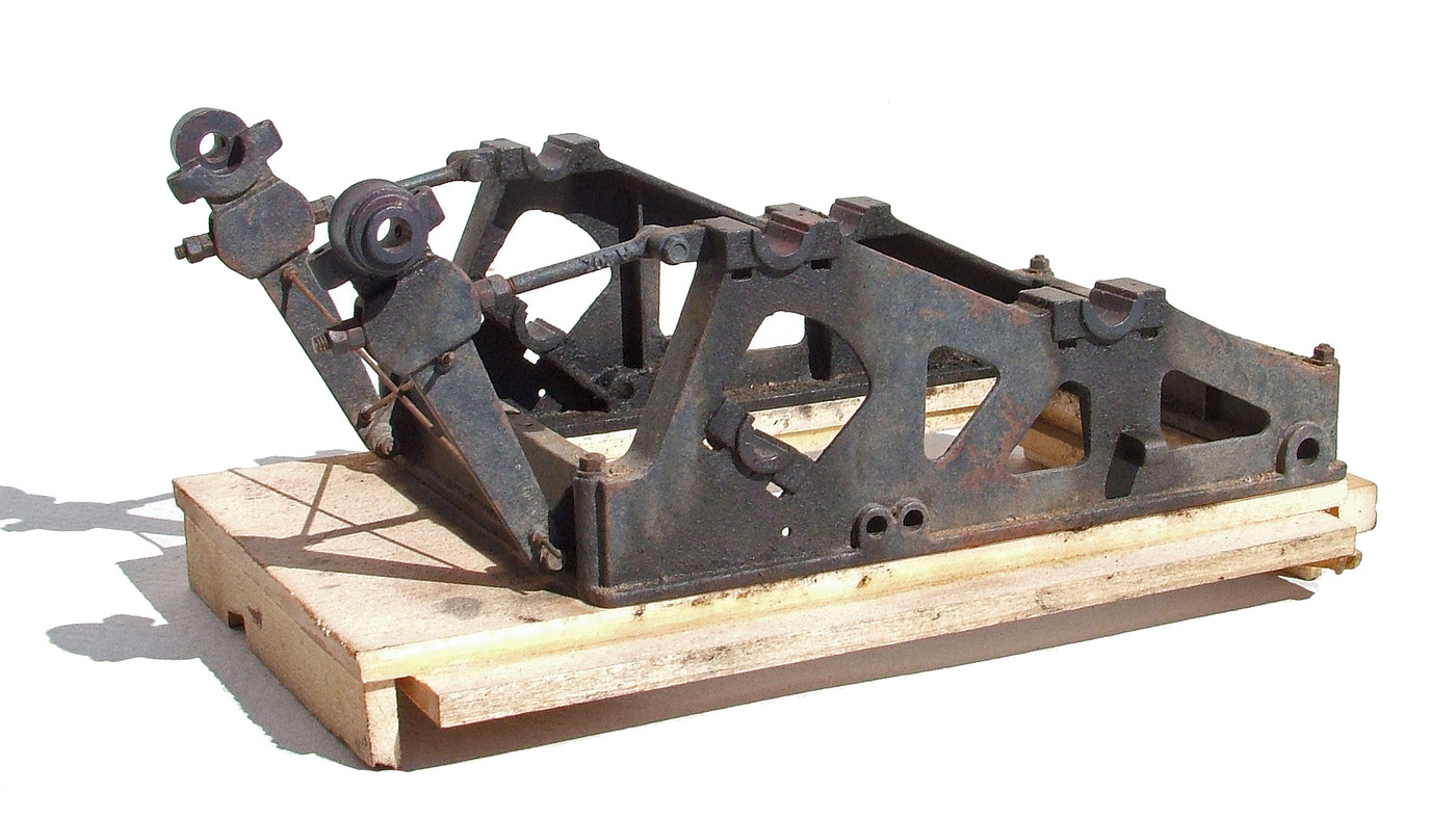

Got the front truss rods installed. Truss rod tips (.025 diameter) made from styrene rod, threaded through a screw plate made from an old watch. Nuts from Scale Hardware.
Also started to weather the inside. The inside details won’t be easily seen when done, but it’s fun to do. Inside debris fastened with liquid Dullcote. Larger pieces with white glue.
« Last Edit: June 20, 2017, 09:55:44 AM by Chuck Doan » Logged
Posts: 546
« Reply #111 on: June 18, 2017, 05:06:05 PM »
That's looking really good, Chuck. How did you do the small numbers on the heavier rods as seen in the first two photos?
Posts: 2372
« Reply #112 on: June 18, 2017, 05:31:17 PM »
Just raised lettering on the 3D model. The prototype had part numbers cast on most of the parts.

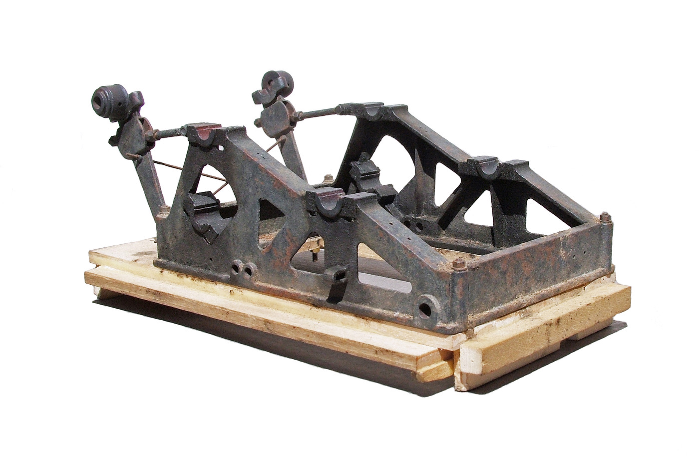

Made a bit of progress this weekend. Working my way around the other side and back (actually the front of the hoist). It is bolted down to a handling pallet with an open center for holding during assembly and weathering.

That could easily pass as a piece of real equipment on a shipping pallet.

Chuck-- This is looking fantastic! Very happy with the plant debris inside and that beat-up rear (front?) beam. Please stay motivated!   DF
